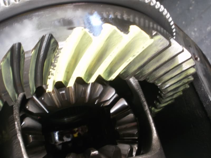

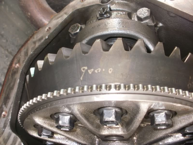

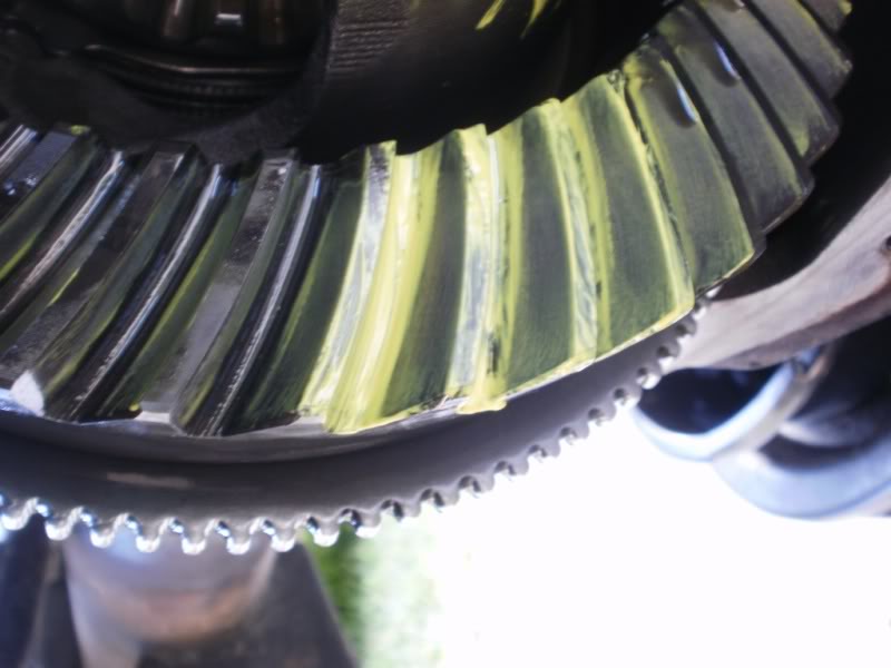

Decided to bring backlash to 0.006 this weekend since it seems I have less noise with the tighter backlash (before it was at 0.007). It wasn't necessarily louder at 0.010, but was at a wider range. It was like from 40 to 55 just about. Now I'm back to 44 to 48. I don't know if I want to go any tighter than that.
Here's why I decided to go 0.006 ... that "900.0" picture ... or is it "0.006?" lol

Drive pattern
Coast pattern (looks a bit wierd). Maybe that's because I used oil paint instead of that lead stuff and it smears better. That and I put it in N to let it rotate a few rotations while it was up there.

The backlash can open up as it wears in, so a little tighter is good.

That was my thinking. Last time I had it at 0.007, it seemed to be getting a little less noisier before I did the pinion bearing replacement and set it to 0.010. The drive pattern is almost hard to see since it has a bit of wear on it by now. By the time the weekend rolls around, I keep thinking of things I can do, but I think I got everything right where it needs to be and the noise is probably from the prior bad install. I'll keep you posted. Tighter backlash and still getting the same temps as above so maybe I did have bearing issues.
