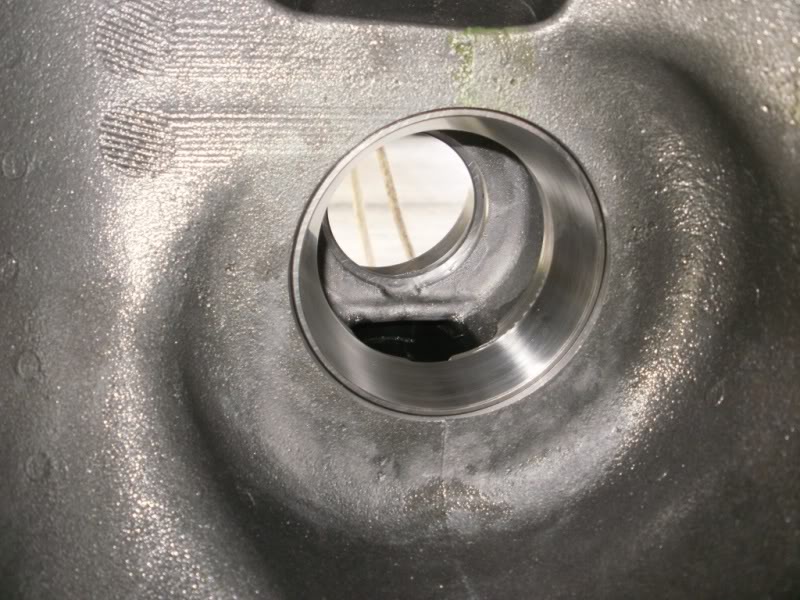

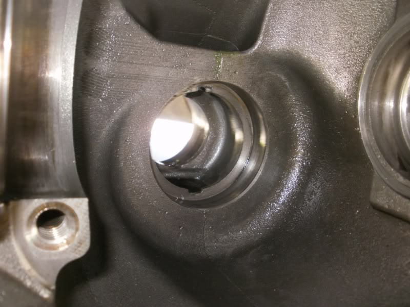

In case you didn't notice, here's races out ...
And new races in ...
Putting them in the freezer definitely helps ... try to put them in overnight.
