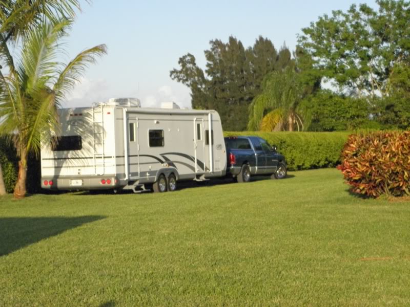

Went on a little "camping" trip to a friend's place for Prez Day Weekend extravaganza - it was 10 miles away. Yes I was nervous ...
But the truck did very well. It made it!
AND, it made it back. Aside the noise I'm having, the 4.56 gears really helps tow this thing. I was in OD at 50 MPH with enough oomph to maintain speed comfortably well - yes, it was on a flat road, but still, I couldn't do that even at 60 with the 3.92's.
Gear noise is all about gone except for noise I hear at 44 to 48 only at maintaining speeds. Hardly any noise accelerating or decelerating any more. I've read that that's due to too close to toe gear mesh, but I'm also hearing bearings or incorrect preload. I've seen the gear pattern and it's just about perfect, but will try to check it out again this weekend. I'm still monitoring temps after most trips and haven't seen anything over 141.8*F now. Some say that's still a little high, though.

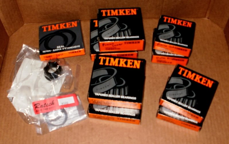

All of my bearings, races, my seal a solid spacer (ratech 4109) and pinion nut came in this week. Ready to give it another go. Wish me luck!
Old Feb 26, 2011 | 01:03 PM
  #80
areinike's Avatar
areinike
Joined: Sep 2010
Posts: 438
I may have found a problem. with the axles out, it takes about 55 in./lbs just to get the assembly turning and from there it's 10. It's hard to start turning everything with the ring gear. I would suspect a binding bearing. I'm taking it all apart and see if I may have overheated something.
