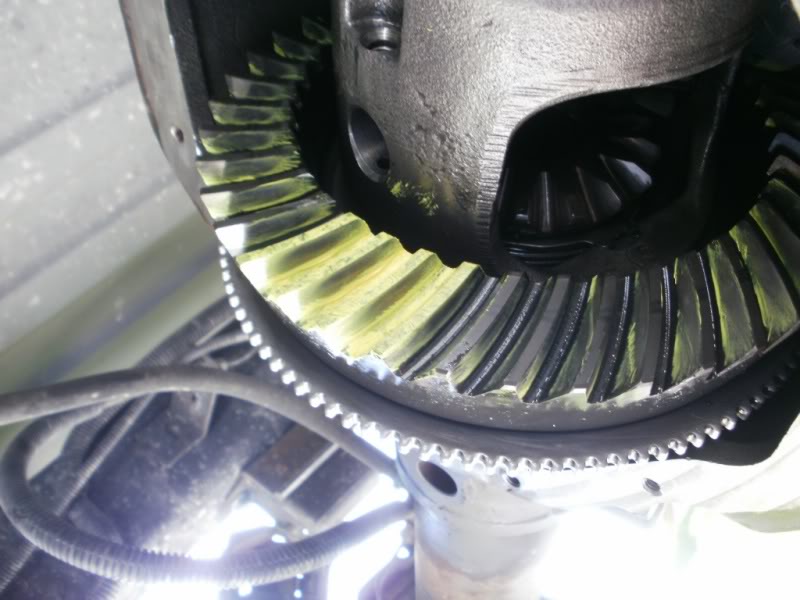

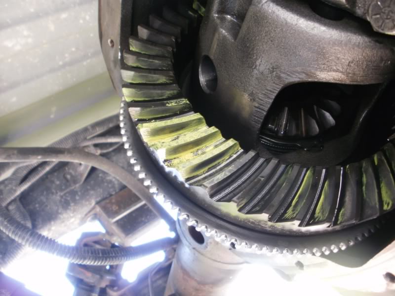

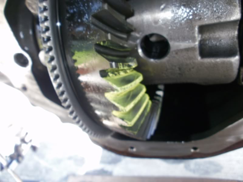

Anyway, love talking to myself. I had a couple of beers last night. So here goes. Today, set the backlash to 0.008 to 0.009 (there was a slight variance of 0.0010 ~ 0.0015). Torqued the backlash adjusters to 75 ft/lbs. Checked gear patterns on both 0.009 and 0.008 sides and results look great to me. I'm going to compare with notes because I think that because the coast mesh is more in than the drive, ever so slightly, that the backlash may be a tad off still, but overall, I think either I'm really close or dead on. It just feels right to me this time. If there's noise still, it won't be because of the install, but because I ran the gears for 400 or so miles with it incorrectly installed. I do like the higher backlash to help with cooling so I may just stick with it.
Drive and coast at 0.008 backlash.
Drive and coast at 0.009 backlash.

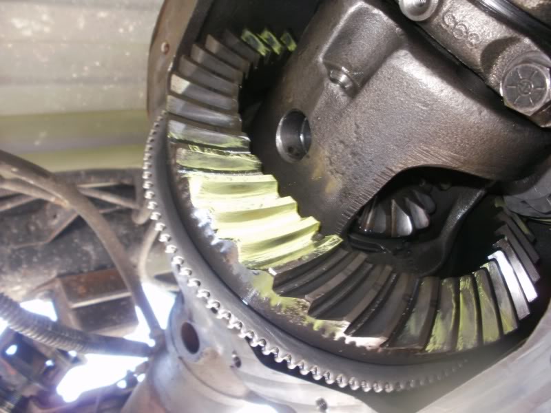

Good shot of the gear mesh.
After verifying the backlash settings, going to fill 'er up and take it for a spin and see what happens. I feel SO much better about this go around, though. Things just worked out, pinion preload feels great (was almost non existent before), backlash adjusters torqued without issue ... just good all around.

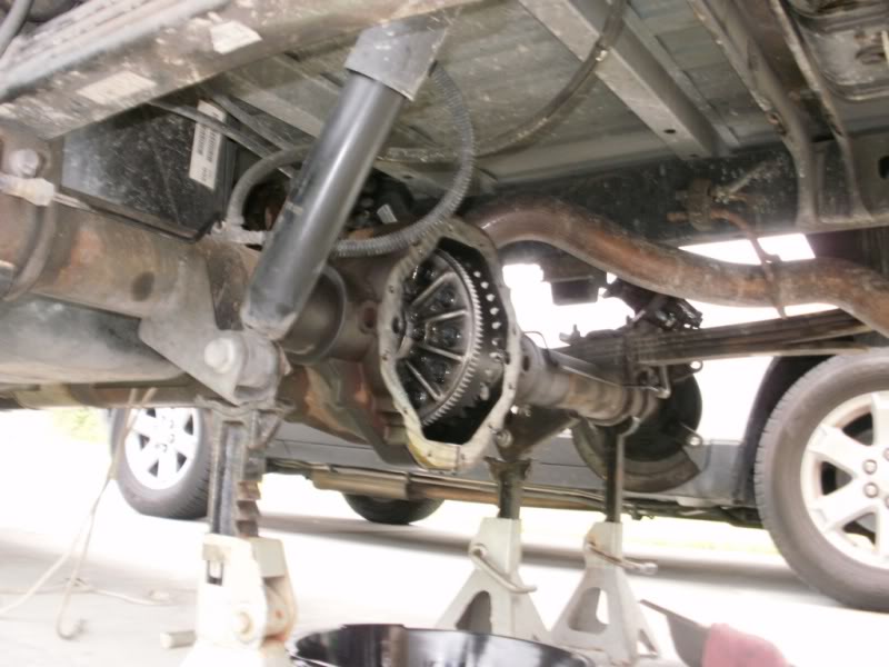

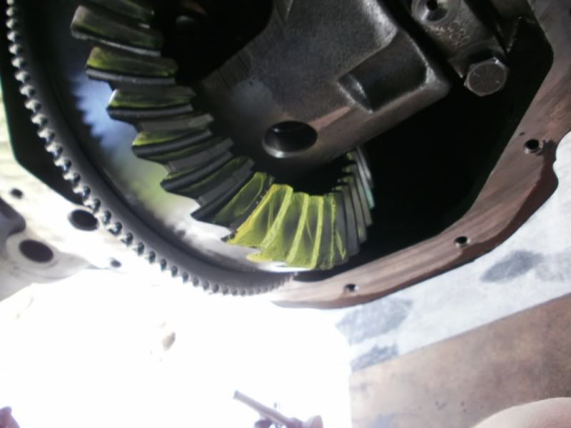

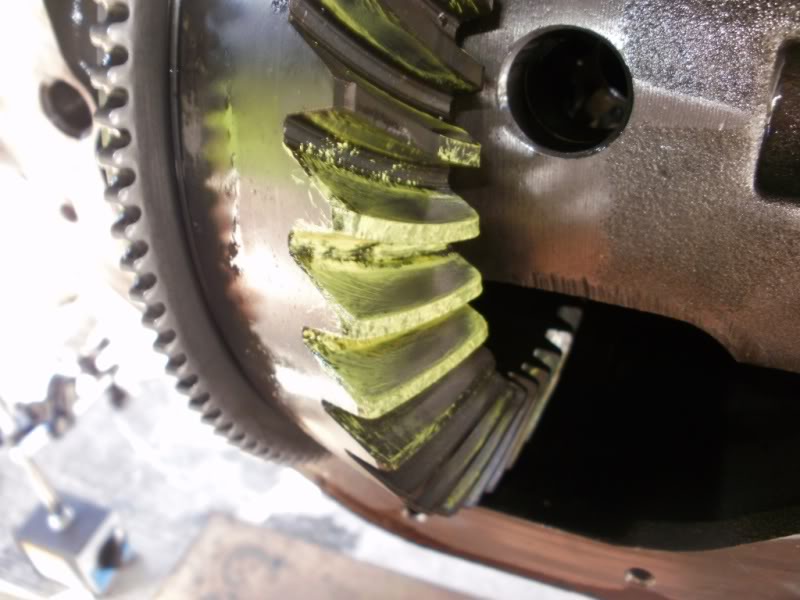

Drive and coast at 0.007 backlash. Perfect. That took a bit of adjustment to get it to that. Adjusting backlash on these thing, you just need to tweak it a tad, and a tad I mean like less and 1/10 turn. This was the result of moving it from 12:00 to 12:05.

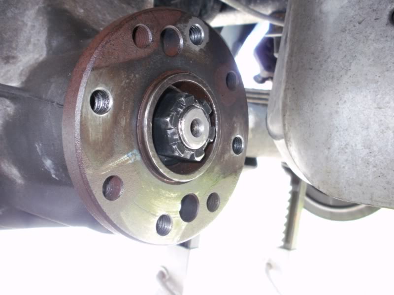

Pinion/Yoke ... Just to compare from previous picture I had. That's a new Mopar pinion nut, cost me enough.
