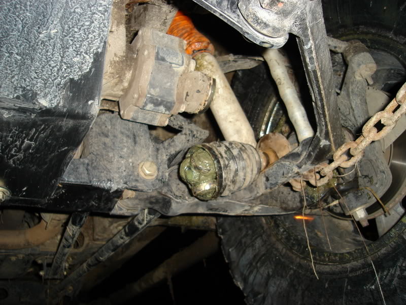

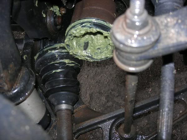

When planning your lift, at that height be VERY aware of the angle of the CV axle! Try to keep it as close to the stock angle as possible. Unlike a SFA truck which can be basically lifted with all suspension lift, you cannot do so on an IFS truck, NO MATTER WHAT ANY SHOP YOU USE TELLS YOU!
This can be done with a combination suspension & body lift, and I'd keep the suspension lift closer to 4" rather than the 6" kits that are so popular. This will keep the angle down to have a better chance of handling the weight of 37"+ tires. Do the rest with a 3" body lift and some cutting/trimming if needed.
And above all, expect this:
