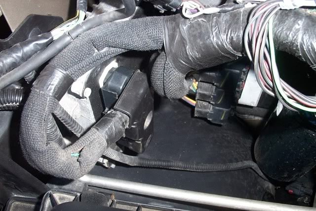

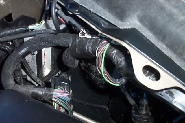

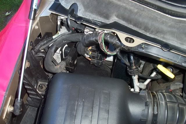

I did the TCM #10 wire mod to my 03 2500 Hemi and it definitely made a difference in the shifting from 1st to 2nd but only at WOT. All other rpm's are still sloppy shifts. I ordered and installed a Transgo HD shift kit only to find out 1/2 way through the install, the guy sent me the wrong kit. But that is another story.
Here is the where the TCM is located. It is mounted to the fender and not the firewall.

Remove the mounting screw from the center...

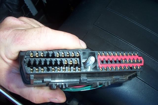

Look for the yellow w/ green strip wire. It should be located on pin #10. You then remove the red pin holder from the center...
