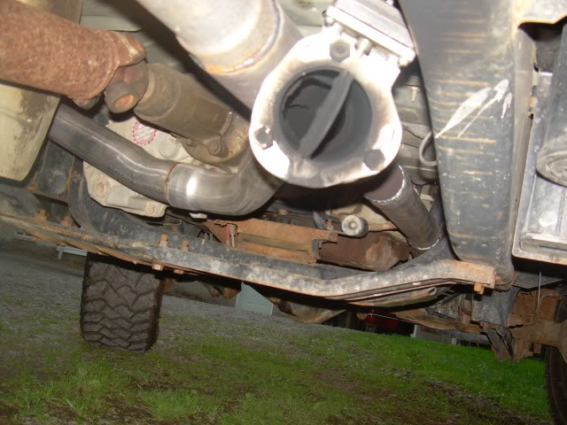

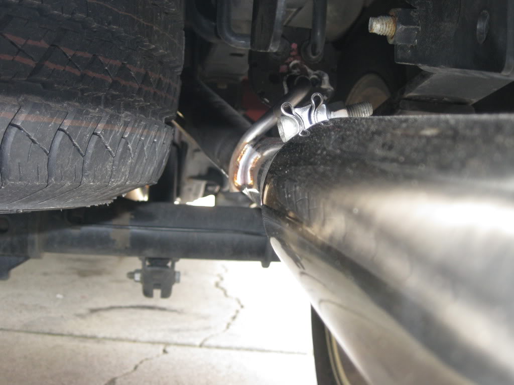

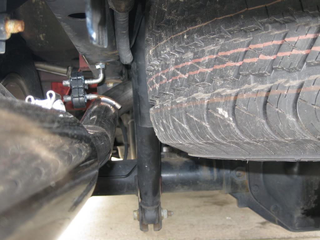

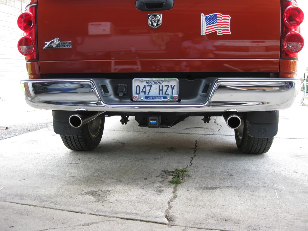

Too low. Here is my Magnaflow cat-back by the rear springs, although mine exits out the rear. (Keeps tires from throwing stuff on my nice stainless tips )
