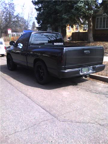

Just cause this is the thread...heres my truck
04 single/short 1500 5.7 Auto 4WD
Suspension (rear) is spring under WITH overload and stock shackle and cranked torsions in front. Its the least amount of drop you get by putting the axle on top of the leafs.
I cant index the torsions without cutting the bumpstop (their literally in the way) so thats my next project....to cut bumpstops and index the bars in the front and notch and add a shackle to the rear. Even with the overload spring in the rear, it bottoms out every time I drive it. Iv got a shorter polyurethane bumpstop in the rear.
Ballistic fabrication sells leaf spring perches for the 3.5 inch axle tube. I spent less than $40 for the flip in the rear.
Attached Thumbnails Lowered Trucks: tech and info....-getattachment.aspx.jpg

wait what...please explain more about what you did to get your drop like that im looking to drop lower but your price seems a hell of alot better than the ones im coming up with....i only want a 2/4 drop cause i haul my quads into the woods....but i dont go off roading per say...and could you post more pics of your truck use photobucket or imageshack and copy and paste img code in reply box....thanks

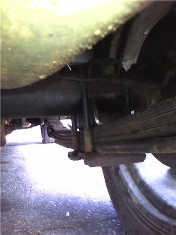

http://www.ballisticfabrication.com/...ch_p_1485.html
brackets and tabs >>>> leaf spring brackets>>>>
gimmie a min for pics

in photobucket it says img code beside the codes your truck looks sick thats why i want more pics....and with those i can use em on the under side of my axle and use the rest of the stock stuff?.....do you have pics of the flip in your rear?
The bracket is the only thing I bought. we spent 3 hours (mostly bullsh*tting/catching up with an old friend) doing it. I used OE U-bolts and all....

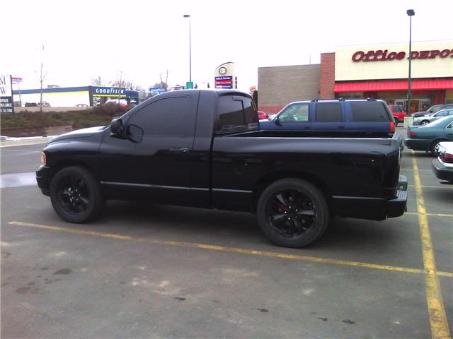

are those stock wheels...what your height from the ground to your top of fenderwell in the center...and you say you bottom out alot or no....you have any more pics of that thing...it looks great....sorry im bombing you with questions but i just gotaa know...also you just lowered your t-bars in the front? right

I started and ended with about 1* of pinion angle.
just remember to weld it. this IS NOT a bolt in kit with little pieces that push up against the stock spring perches that hold the diff housing from spinning.
These posts are about what I did. Im NOT a MFG nor do I have lots of R&D done on these trucks. Therefore I CANNOT be responsible if anyone does this and breaks their ****. my trucks not that low really
-Their 22 inch DIP wheels with 305/40-22 goodyears.
-I bottom out A LOT
-torsion bar adjuster bolts are NOT pressing on the torsion keys. they are as low as they will go without cutting the bumpstops and indexing the bars.
