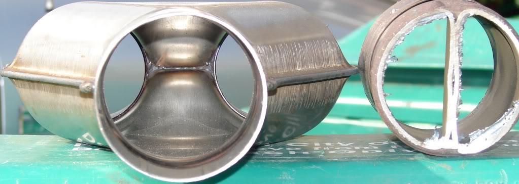

Do a search for photos of the stock y and you will see why it is a good thing to remove it. The factory just crushed the two stock pipes together to form a y, very restrictive.

Aftermarket Y vs stock Y-

Tell the one shop he's a moron and go somewhere else. The stock Y is VERY restrictive (look at frogs pics). Either replace it with something better (magnaflow makes a nice replacement) or go duals with an X or H pipe.
