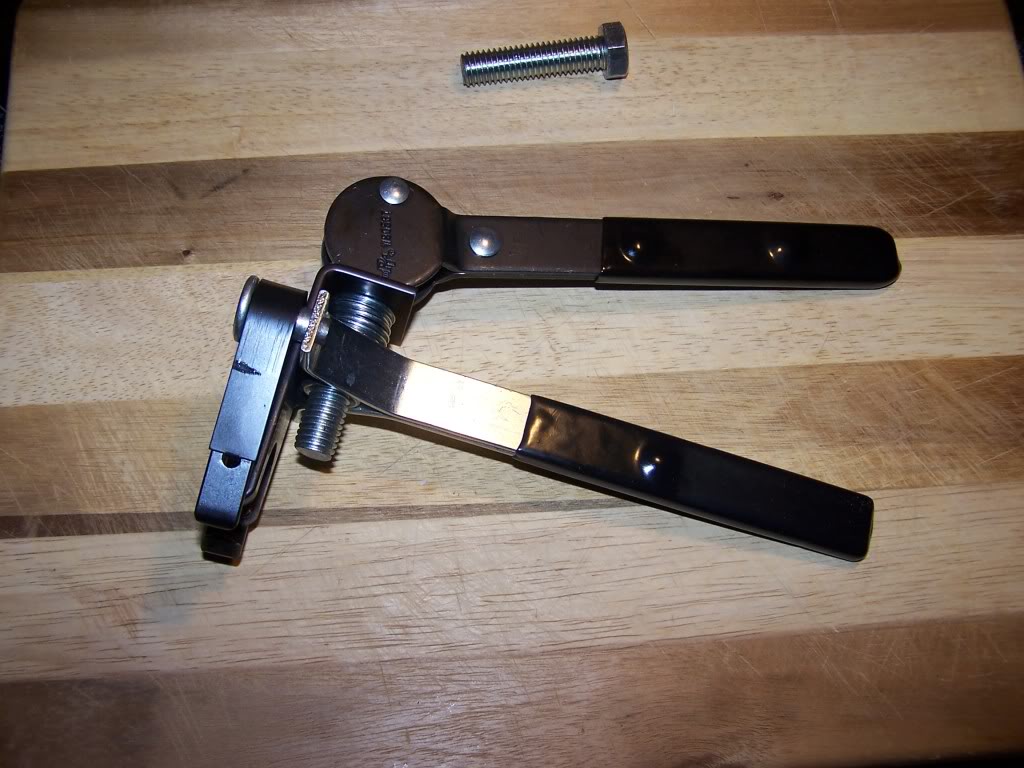

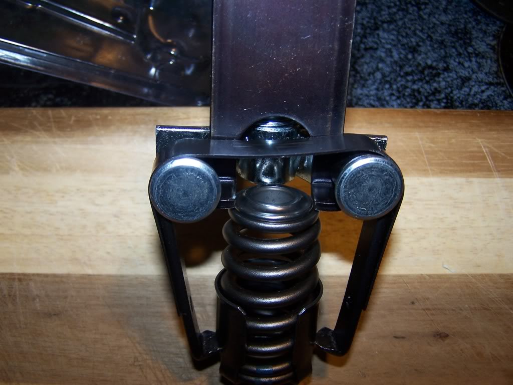

Yeah! I "thought" I was almost there too! The spring tool I bought will not work with these springs due to the metal bucket. The tool operates with a handle to compress spring or removal of handle in tight spots and compress spring with bolt. The bolt is not long enough due to my having to place the tools jaws all the way at the bottom (See pic below) So, I tried it also with the handle and the bracket that contacts the spring is too wide, it barely sits on the edge of the spring and when it starts to compress, the spring pops out. I've tried it many times....so the option of getting a longer bolt won't work. Advance has one like supercharged shows in his pics with the star handle on top. That's my only option unless the guy who makes the custom tool can get one out overnighted to me tomorrow. Is he on this forum? I will try e-mailing him at that address that Al gave me. This seems to be the only hold up now. uuughhh
OR, if someone has the trust in me that has one of the custom made tools, let me know what your fee would be to rent it to me, take to FedEx, etc and overnight it to me for saturday delivery. I have a FedEx account that you could use. Just PM me. (Al, no offense, but don't want to pay FedEx from England)
Broken intake spring...popped on both sides........

what does the top of that tool look like (take a pic) where the bolt meets the handle area...

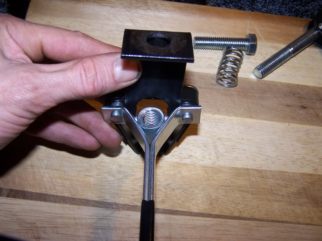

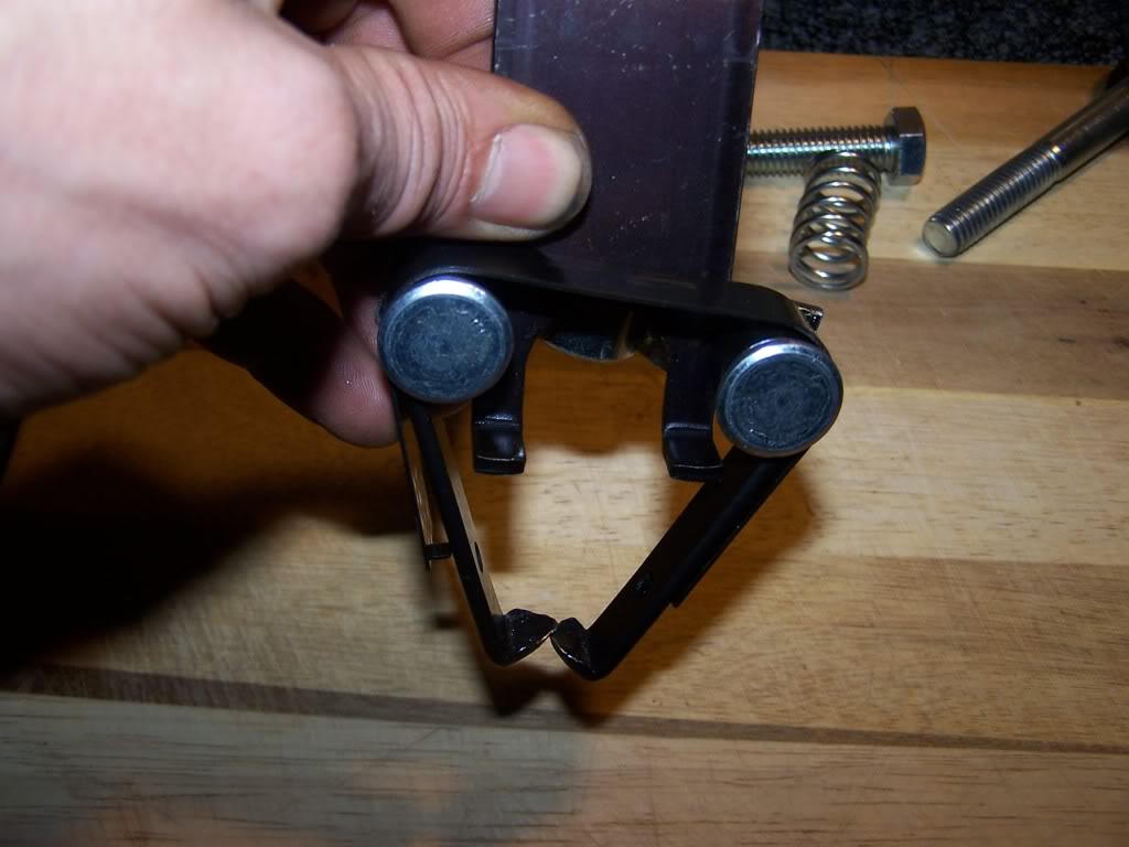

I have an idea. I can call a welding shop and see if they can weld two small extensions onto the tools prongs as they are just too wide. Then I could just get a longer bolt to depress the spring with. One side touches just a hair of one side of the retainer in the spring and the other side is on the very edge of the spring....which slides off under pressure.
Tool with handle:
Top of tool as requested:
View of jaws and compression jaw....(where I could possibly get something welded on there to depress the spring correctly)

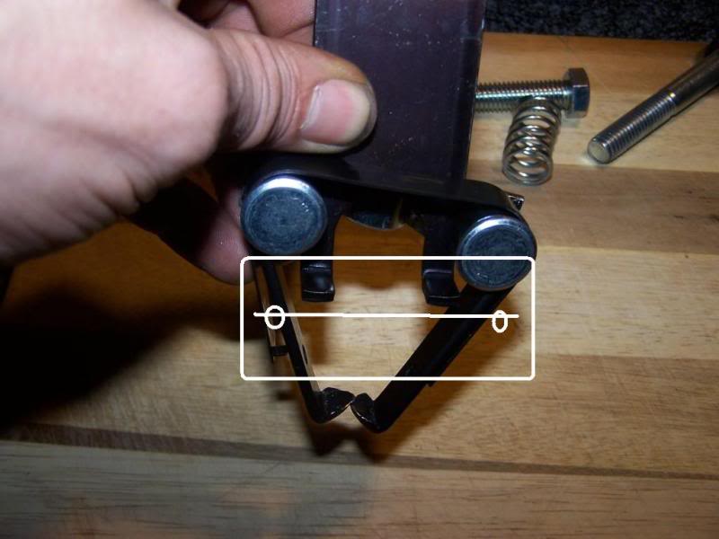

naw... try this ... get a couple of pieces of metal from home depot that will allow you to build a bracket around the pieces that are slipping off. you'd have to figure out which pieces to use but it may be worth a shot...
Steve, I like where you are going. How about a hose clamp around the fingers?
