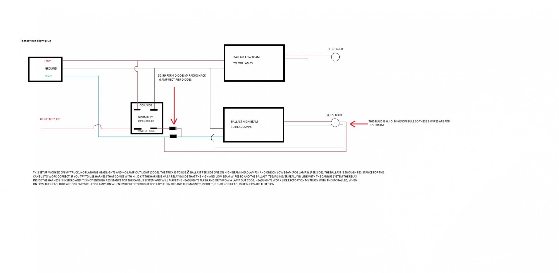

No offense taken, Im just posting what worked for my 02 and my fathers 07 Ram's to see if it would help anyone else out

When you use the harness that comes with these kits all the CANBUS is trying to read resistance fron is the relay inside the harness, the relay inside the harness does no provide enough resistance to "trick" the CANBUS but if you wire one ballast to the low beam and one to the high beam side of the factory harness, they do have enough resistance to trick the CANBUS but you have to have one wired to low and one wired to high
Old Apr 22, 2013 | 02:59 PM
  #623
DonnieHumphrey's Avatar
DonnieHumphrey
Joined: Apr 2013
Posts: 19
and of course the relay and rectifier or diode

And the flashing our trucks wasnt from capacitors in the ballast is was from the CANBUS doing something like a system check because it would do it with relays installed, no ballasts installed or capacitors but you could hear and feel the relays switching open/ closed and my fathers 07 ram 3500 would stop after 5 tries and stay off

These are ordinary Kensun H.I.D kits from Amazon that I purchased.
