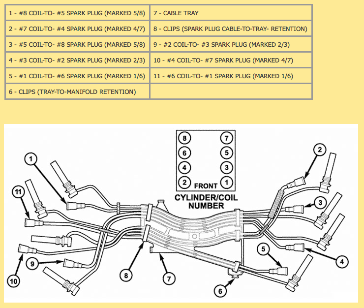

I am fortunate to have not yet had to deal with any coil problems, (yet). The hemi has 16 plugs, two plugs per cylinder. One plug is combustion ignition the other plug is waste exhaust. They do not go off at the same time. The combustion plug is paired with the exhaust plug on a separate cylinder. I am not absolutely certain of the pairings and someone could hopefully confirm. They may be 1+6, 8+5, 4+7, 3+2. Point of saying this is that a coil code for #1 may actually be rooted in the the paired waste coil or spark lead from #6. You may not be dealing with a coil problem on #1 but actually an ignition wiring problem coming across from #6 ... maybe. Or maybe a crossover wire is hooked up to the wrong cylinder.
... picture for reference. Grabbed off the web.
Hope that helps.

FaceDeAce.... What you said is now my exact plan of attack!! The injectors will be my next hurdle to see if I can isolate the injector that is the culprit! The coil code I believe was from before when I was moving the dead coil around. And thank you!!
