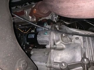

Is there a heat shield around the starter ? If its cranking slow like not cranking normal speed perhaps the starter is getting to much heat on it which Heat soak can usually be solved by installing a heat shield on the starter; this will reflect the heat away from starter , also clean all the grounds under the hood,,as it sounds like something limiting the the starter ,,like to much heat on starter or improper voltage or dirty grounds all can make a starter crank slow after its warmed up
There is no shield when I replaced it last year. Where can I purchase a heat shield for it? I will clean around grounding cables too. Like I said, the truck has been trouble free. Thanks for input.

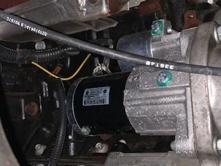

I see that there are two green designated bolts- starter body and solenoid. Perhaps attaching an external ground may help. Adding a heat shield could help; however, its never been a problem for 10 years!
