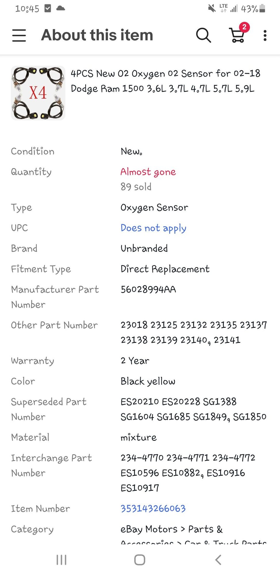

I'm not sure what brand I just know they were bought off ebay for like 50 for the set of 4. I can look and see and let you know here shortly.

So I took a screenshot but they are "unbranded" I had thought about that before but figured since the other 3 were good then it was something other than the brand especially since I moved the sensors around and was only getting code for that one location

Typically you shouldn't get unbranded parts, especially when it comes to sensors.

Yea I didn't realize until after I installed them. I didn't purchase them, my grandfather did. It was an issue before the new sensors as well but ill purchase new ones when I can. Whats the recommended brand to get for the 3rd gens?

I tend to hear that Denso is good. Not sure how good NTK is but I have yet to hear anything negative about them. Just stay away from Bosch, these trucks don't like their sensors for some reason.

NTK and Denso were both OEM suppliers. They work great.
If you had the same code before replacing the sensor, then its likely a wiring issue.
