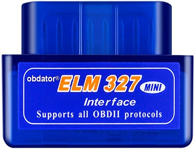

Go to amazon and get a bluetooth obd2 for $14 delivered, and then download torque on your phone - its free or get the pro version for a couple bucks. Then you can start looking into what is really going on.
The other option is keep reloading the parts cannon using google posts of other people using similar guessing techniques as a guidance system :-)
