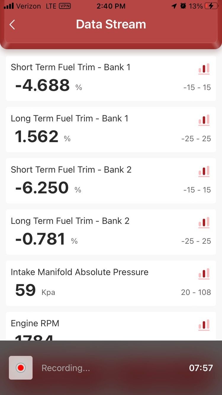

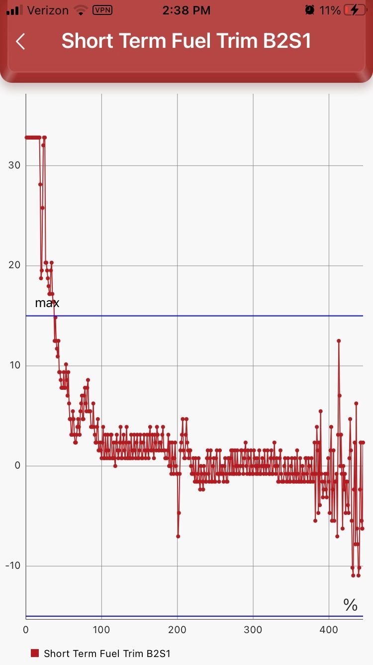

Hmm... yeah negative fuel trim isn't indicative of unmetered air input (Vac leak). STFT should settle out, but it isn't. The problem with your tool is it shows snapshots, and proper analysis is done watching changes over time (graphs of snapshots, rather than a single value). I like the ELM327 and Torque phone app. Looking at different RPM and load, and how STFT and LTFT change, can help you figure out what is going on.
When I really learned this stuff a while back, I found a great pair of videos that really walk you through how the inputs (sensors) are reacted to by the computer, and the controls used by the computer. I definitely don't do enough of this to keep it all in memory, I usually have to go relearn/remind myself how it works. These videos are great for showing you how to capture the data and think through what is going on.

Wowsers. That thing is pulling a LOT of fuel....... Real curious why..... Wonder if what you are seeing is a lean-burn miss......

So, my thought was to place the original injectors back in. HeyYou those are snap shots but yes my tool does capture while the engine is running, I just took pictures of the final results. I am not sure If I can upload the actual video of what is going on. I will watch the video you sent bd I will also put back the original injectors....I will report back tonight.

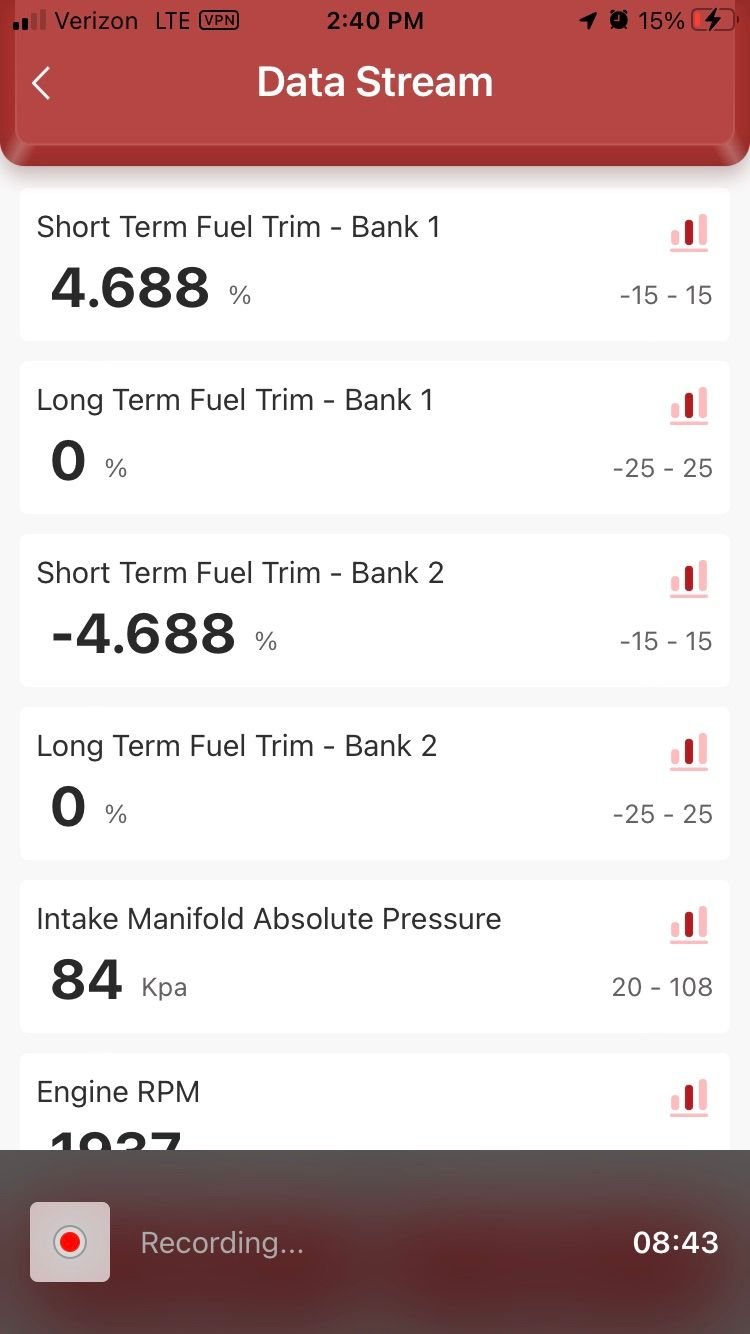

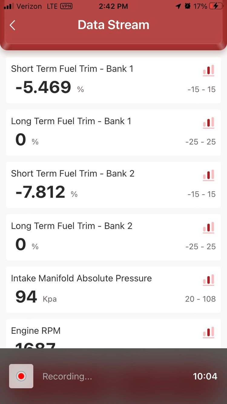

hey everyone, I am pleased to say that the truck is fixed... It turned out to be the new fuel injectors. However watching those videos that HeyYou sent helped out tremendously. I recommend watching them regardless. So I learned that not everything you see on Youtube is not always something that you can perform on your own vehicle. I thank this forum for all the assistance that I received I will submit more pics of the new readings.

Default Correction after oe fuel injectors replaced

Those numbers look a LOT better.
