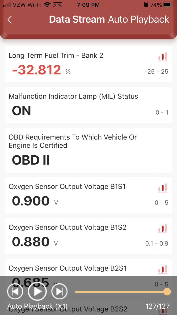

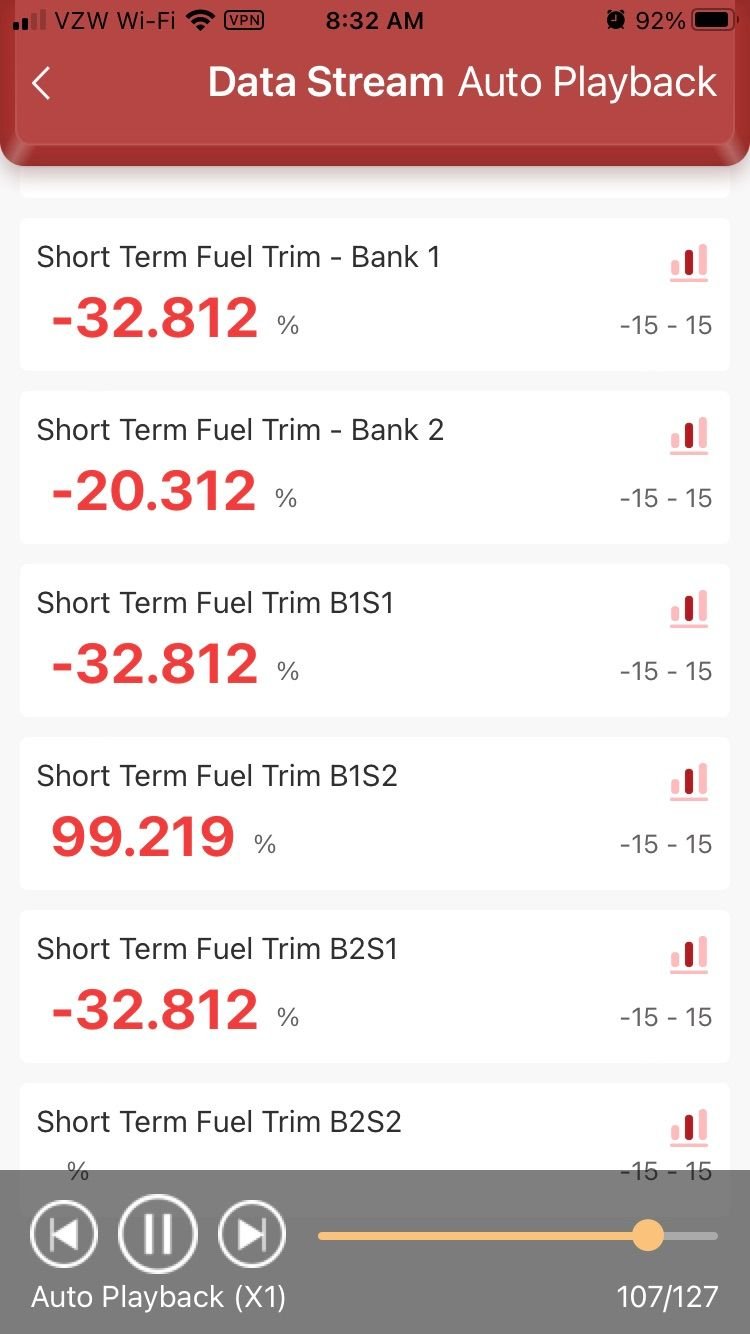

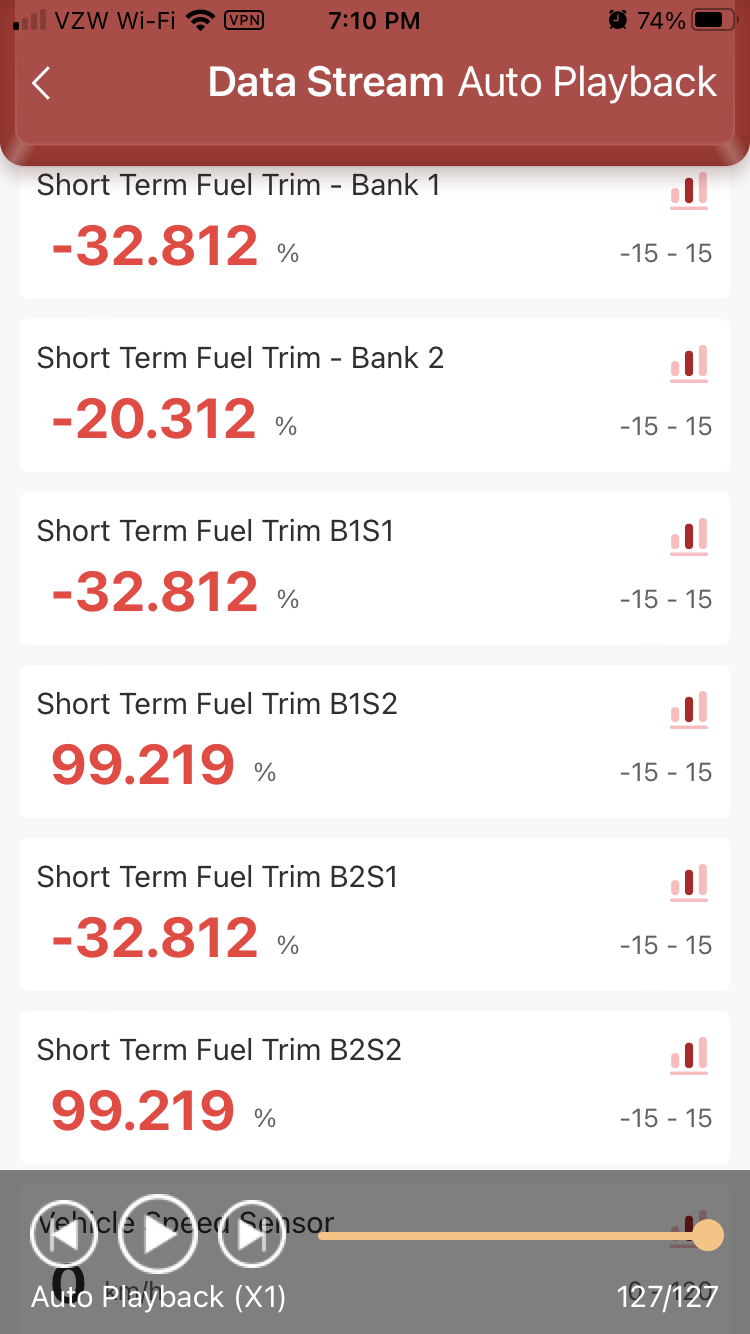

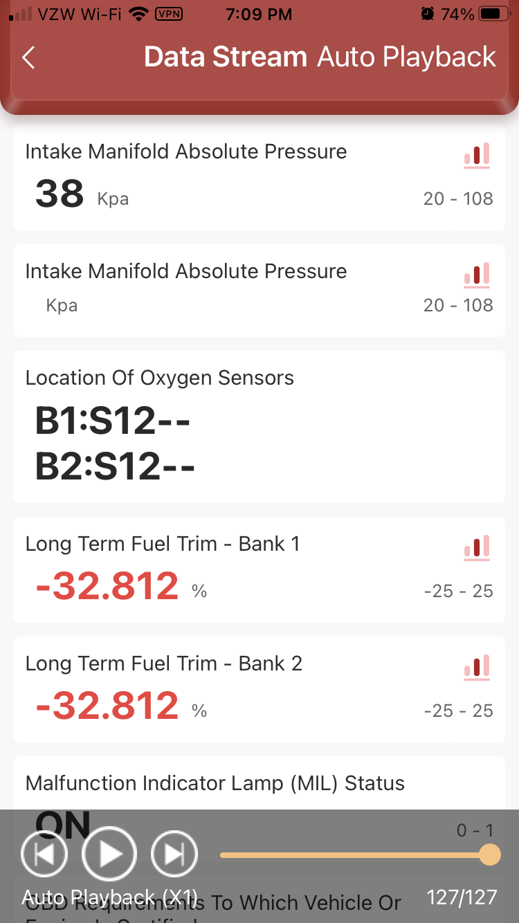

Old Apr 14, 2023 | 07:05 PM
  #99
racerxv6's Avatar
racerxv6
Joined: Dec 2012
Posts: 286
Likes: 27
From: Upstate SC
Default Fuel trims
Funny you mention fuel trims. Here is a sample reading while running from my ThinkDiag scan tool. I think you will be surprised at what it says. I was also thinking d Td he same thing about the intake. Can you help me understand what I am looking at?
Old Apr 14, 2023 | 07:10 PM
  #100
racerxv6's Avatar
racerxv6
Joined: Dec 2012
Posts: 286
Likes: 27
From: Upstate SC
Default More pics from reading
