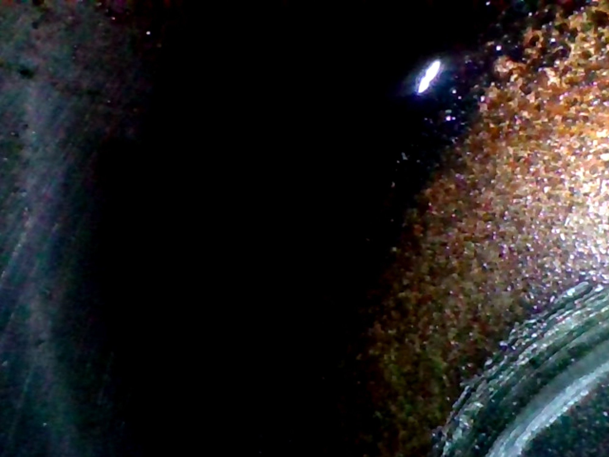

So I borrowed my coworkers endoscope and got the best pic j could. But it definitely looks like there is metal sitting on the piston. Head comes off tomorrow.

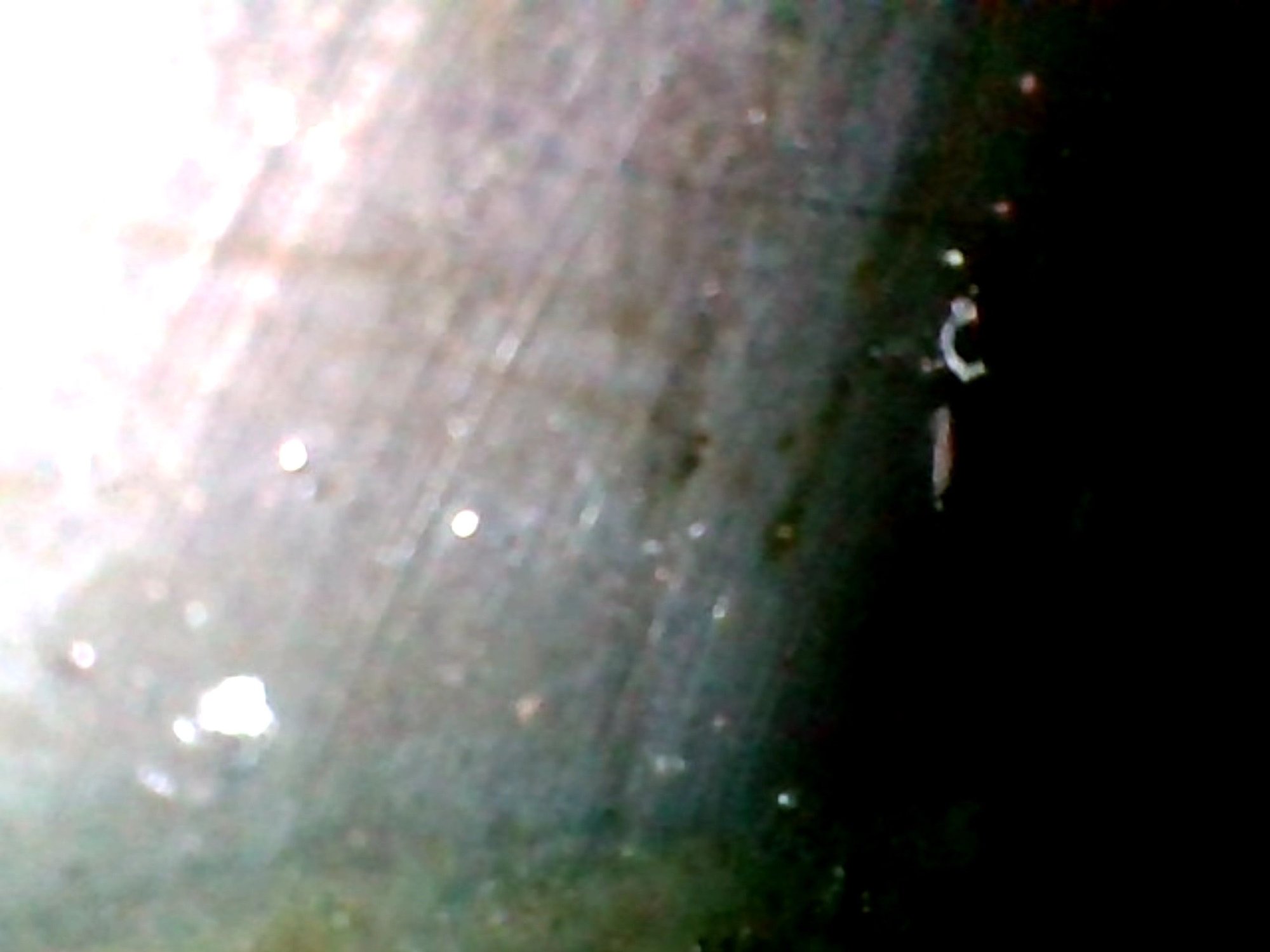

so here is another pic. Which looks like a bigger piece or the valve hit the piston. .

Posts: 87,479
Can you see the valves/seats?

From: Upstate SC
In the cylinder or in the valve port? I couldn't see anything other than what I posted. I am tearing the head off tomorrow. The scope isn't the easiest thing to use. Not the best either...

Posts: 87,479
Yeah, higher resolution would be better..... Be interesting to see what you find.
