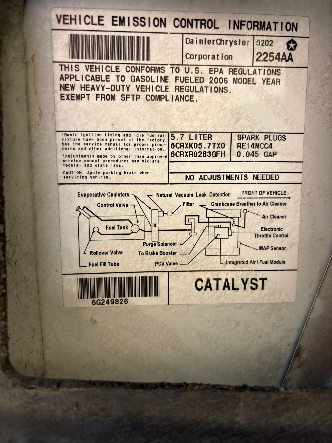

How would I document this. The factory service manual does not talk about a block-off plate. I'm looking at section 25, page 52.
Here's a pic of the "vehicle emission control information" posted on the underside of the hood. Is there something in the information, or exempted that I can point out to the smog guy?
How can I lead the smog guy to concluding the block-off plate is a regular part of this engine/truck?
Thanks for your help!!!

I found a bunch of threads on this and other forums saying that my 2006 2500 Hemi does not have an EGR System. How would I document this?
Old Apr 21, 2024 | 08:31 PM
Posts: 87,467
Likes: 4,220
Show the tech the service manual, tell him to find the section on EGR. (it shouldn't exist.)
My 96 with the 5.9 didn't have egr either, however, the intake manifold DID have the provision for it, with a blockoff plate where the valve would be. Dodge was just using up excess inventory of the 95 and older manifolds that DID have egr.
The 'tech' should know, or have resources to consult, as to weather your truck should have it or not.
I would also point out, that if the truck was supposed to have it, but, doesn't, there would be a code or three whining about it, or, the software version wouldn't match what was on the label.....

Thanks for all the replies. I found documentation in the 2006 Dodge Ram 2500/3500 Parts Manual. Group 025, Figure 025-205
https://ia601009.us.archive.org/10/i...99%20pages.pdf
I'll take this into the smog shop tomorrow and see what they say, and if they will actually charge me a $40 recheck fee... They better not...

The only thing that gives me pause is that your emissions sticker mentions only EPA compliance. California requires vehicles to be CARB compliant. That doesn't mean it magically needs EGR.. my 03 1500 has no EGR from the factory and its a CA truck. But it could mean they could fail it for not having a CARB cert.
Did you buy the truck from out of state?
