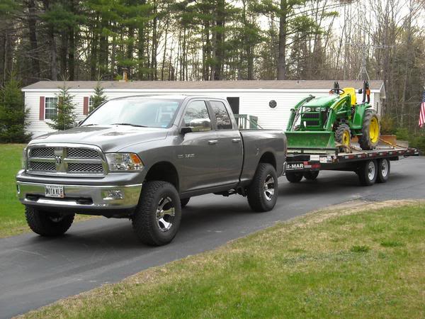

Cool
I towed a John Deere 3320 on a Brimar tilt deck trailer... I added everything up and the total weight was 8,450. I was actually impressed at how well it hauled.
4,560 lbs - Tractor, loader, loaded tires, rear blade
3,890 lbs - Tilt deck 14,000 GVW trailer

does nobody care if they are running legal or not?

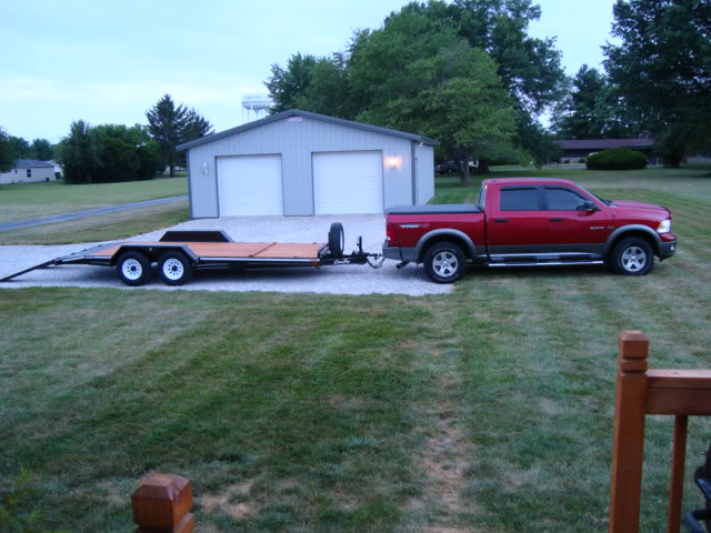

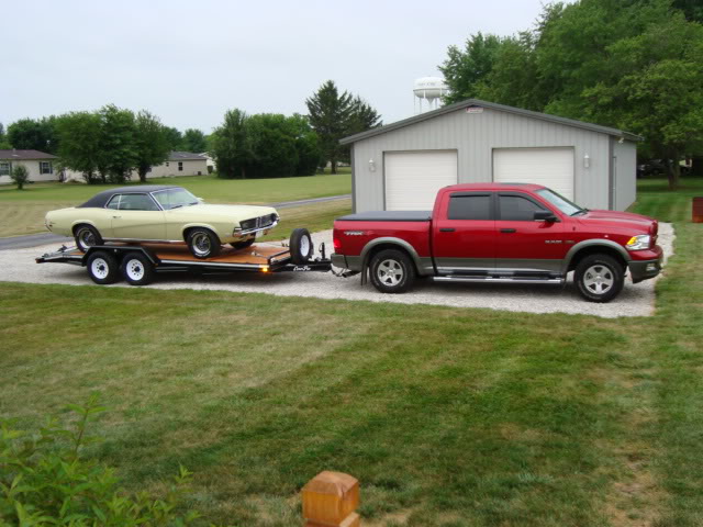

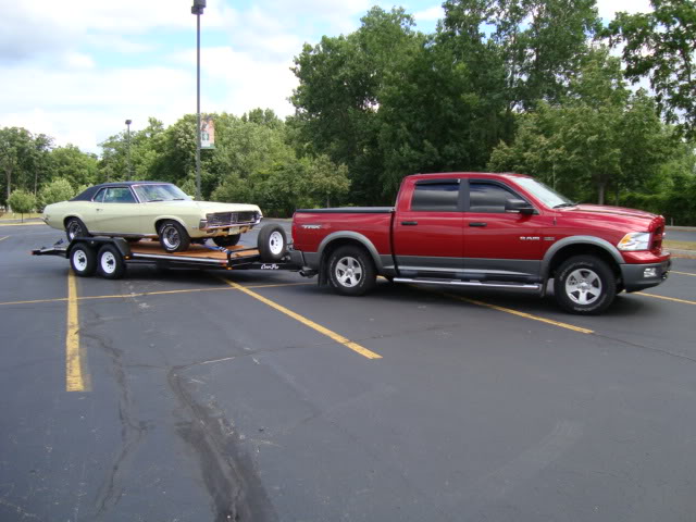

Default First time towing with my 09
Well, I finally got to tow my 69 Cougar yesterday. My impressions are that my 07 Quadcab Laramie towed better. I noticed a little bouncing when I hit a bump in the road. 09 has much more power tho when accelerating. You could not even tell it was back there when taking off. The trip was 60 miles each way with 95% all interstate driving. 60mph seemed to be where it ran best. I used the tow/haul button for half the trip then turned it off. It seemed to run better with the tow mode off. It seemed to be needed tho while in town. The 18 foot trailer weighs 2400 pounds and the car is around 3600 pounds. Transmission temp was 132 on the way up at 57 degrees F outside temp. On the way home it was 142 at 68. The truck squatted more than my 07 but not as bad as I thought it would. I have pics of just the trailer and with the car. The pics in my stone driveway are a bit misleading as the ground is not level. The pics on pavement are before the trip home.
