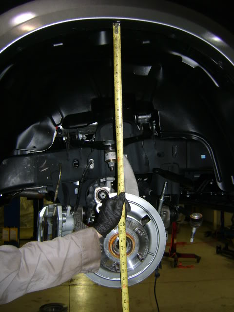

Step 1:
Measure the full amount of droop with the factory strut installed (26 inches)

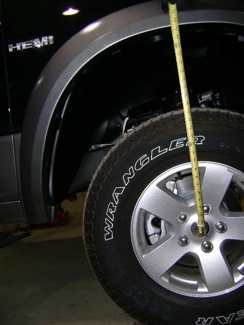

Step 2:
Take everything out except the control arms. Notice the CV shaft isn't even in there to hold things up, brakes are off, sway bar is disconnected as well as the tie rod ends. The nuts to all of the control arms are broke loose. Measure again (27-1/4 inches) - the pics are for reference, numbers came from holding the tape with 2 hands.
Everything is loose - what's keeping this from drooping out anymore? Answer - The upper balljoint is maxed out. You can now measure the distance from the upper strut mounting plate to where it used to mount... it's almost 1 inch. That's all you can physically fit in there before something is in a bind.
... yes you are correct that there are issues with a stock trucks, but you have to admit that stressing something past the limits it was intended to work is not good. If you never offroad your truck - you'll more than likely never have issues, it'll never see this point of your suspension travel. But as someone else said, if you take it through whoops, or use your truck offroad... it is not the ideal setup and you are asking for problems.
I'm not saying we all go out and buy 100k trophy trucks as daily drivers. All I'm saying is, if you buy a spacer kit - dont put over 1 inch on top of your factory strut - which is really about 1-1/2 inches of lift.

jball,
Thanks a bunch for taking the time to post all that!
