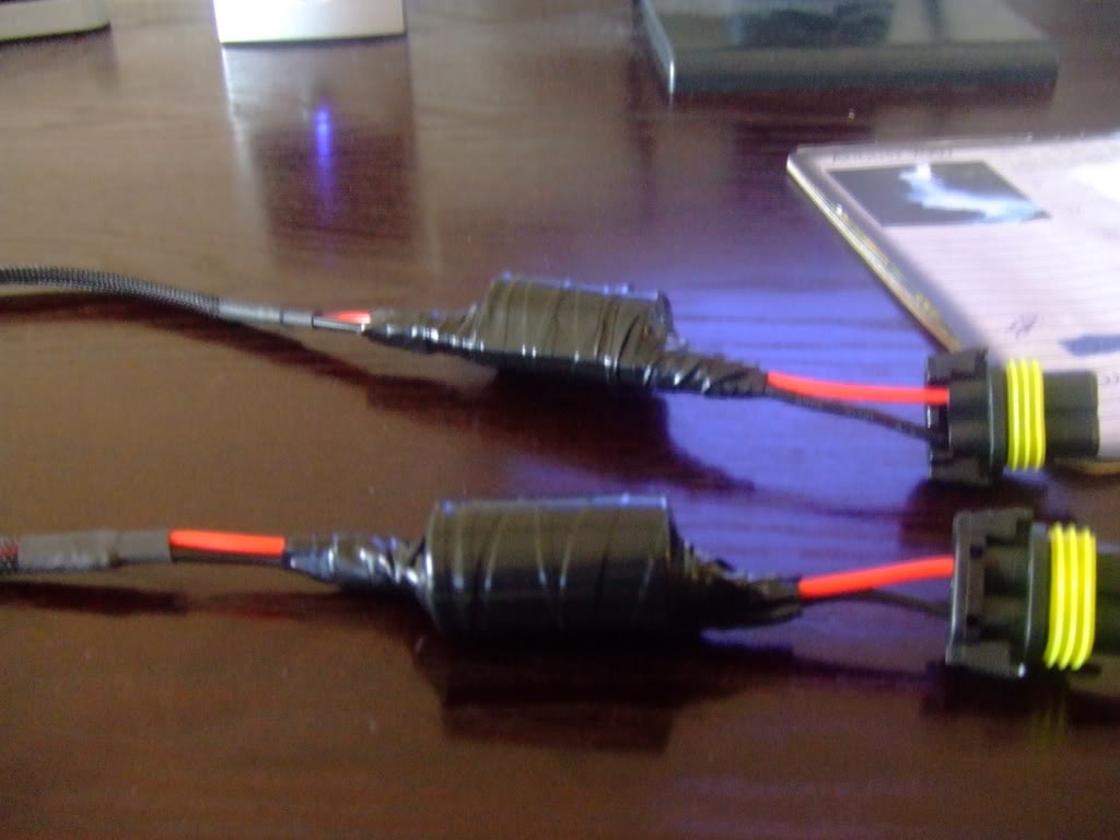

and wrapped up with electrical tape ..

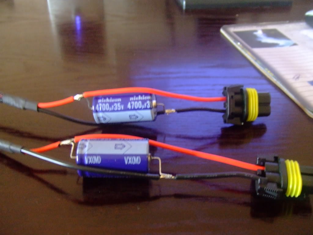

The BELOW pic is how i installed mine.. i wish i had done it like the above as it's a cleaner install, but i wanted to be able to remove the capacitors easily if a bulb goes and i have to move the capacitor to a new bulb harness. i just simply had no idea if this was going to work so i figured it would easy to remove the wire taps and toss the capacitors if the fix didnt work .. well it does .. yay ..
the below is how it looks before attaching wire taps to bulb harness .. i also purchased the wire taps and heat shrink tubing at radio shack ..

In the above picture of the capacitor connections, the soldering and connection itself looks great. However, never ever tape over any electrical components. This will cause over heating and premature failure of the capacitor. I am not a car mechanic, I am a electronics technician. To correctly insulate the bare leads exiting the capacitor, a small piece of shrink wrap up to the barrel of the cap would have been sufficient. Taping over them is very bad idea. Plus it looks like crap too.
In general I try to never use electrical tape on any electronic parts or installations. This is one pet peeve I have with auto makers. They still use cheap black tape when much better materials are available.
