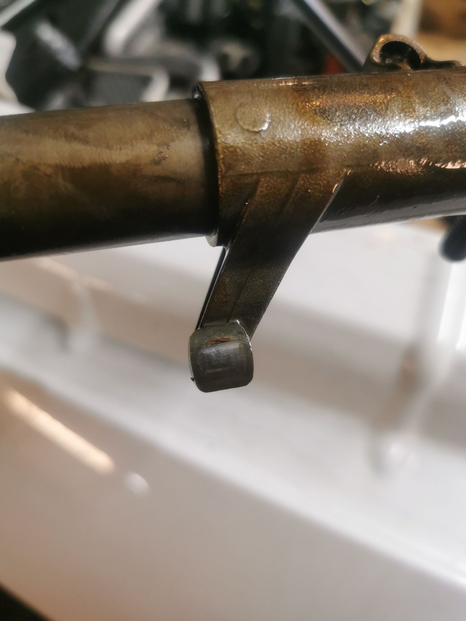

priming (attached pictures):
-Assembly lube
-dipped in oil for a couple of hours

I would make sure all the oily holes are lined up. Are the lifters the same from the left head to the right head? And I check all the rockers to make sure you don't have a pugged oil port on the rocker. I would also check the push rods to see if there is blockage. You could have a plug rocker shaft. By any change do you remove the oil control valve and inspect for debris?
Thanks for the ideas.
Every time before installing the push rods I blow air into them (using air compressor) then insect them using a flash light (shine through) to make sure there is no blockage.
It's not easy to see inside of the shaft but I do use compressed seafoam and air blower to push out whatever is inside the shaft.
about OCVs, I am assuming you're talking about the MDS solenoids, I never remove them unless the MDS isn't kicking in or throwing code, also the last job that I did the truck was extremely quite before I started the job so if any of the valves were bad then they should've made the engine tick before the lifter job. However you might be onto something here so I'll give it a shot as it's easy to get them out.
