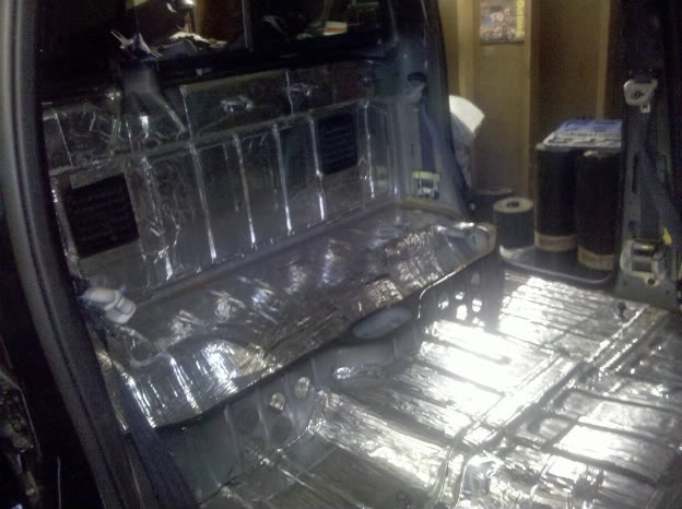

Todays update:
finished doing the prep wiring for the new speakers and then put down all the sound damplifier on the floor. Tomorrow will be sealing the doors with aluminum sheet metal/screws, dampening the doors, putting in the closed cell foam and putting the carpet back on. If im able to finish all that, i'll start making custom speaker brackets (using 6.5" instead of 6x9) and starting the subwoofer box frame

Man after seeing all this Im almost depressed about my install now. I think if I was gonna go through this much trouble I'd have done a blowthrough box. Im anxious to see how this turns out though
