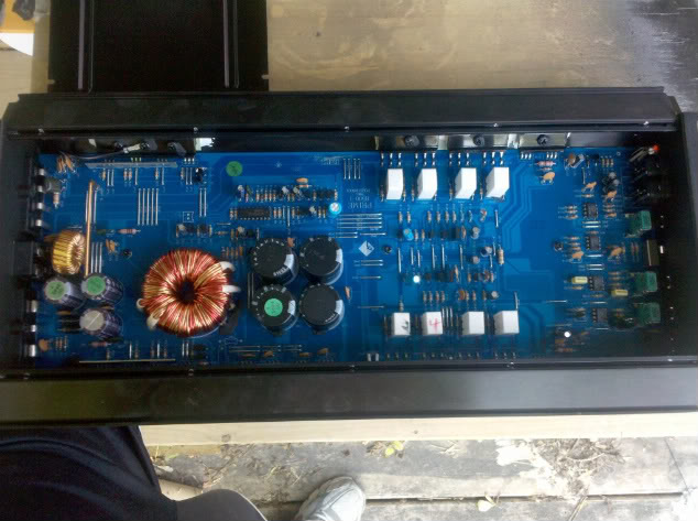

I decided to move on towards the amps. Got curious so i took the back plate off one of the amps and found this:

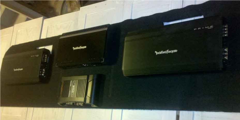

I made the amp rack out of 1/2" MDF. Its strong enough to hold everything no problem, but not so thick it'll interfere with clearance issues with the amps and seats. Every 1/4" matters back there. I wrapped it with black speaker box carpet.

I positioned the amps how i wanted them and screwed them in using 1/2" screws. Nothing pokes out the back and they're on there very solid. The whole thing weighs about 30lbs (just a guess)

very nice work af...just becareful opening amps cause some places wont warranty them if the "seal" is broken....but very nice job....cant wait to see more....

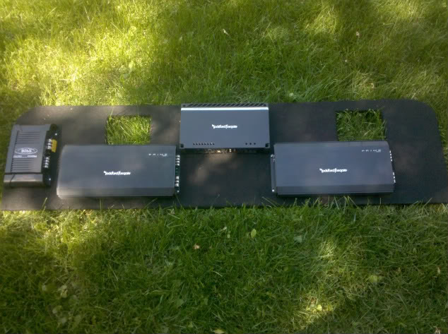

Last night i realized i didnt leave a spot for the center seatbelt spool. DOH!! So i had to rearrange the amps. Heres the new layout. I actually like it better.

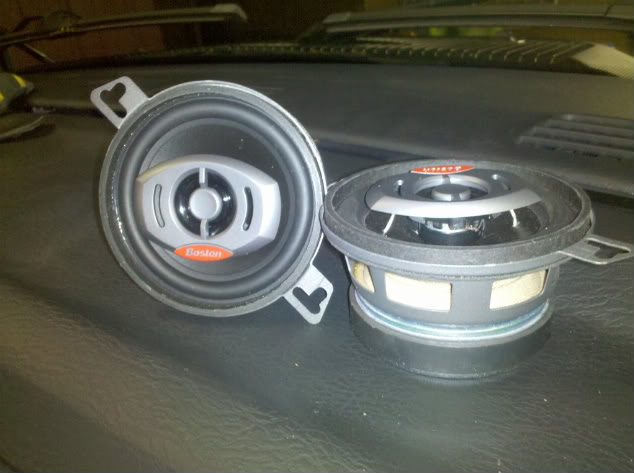

The 3.5" speakers came today. Boston Acoustic S35. They literally took 10 minutes to install. Piece of cake. Note the size of the magnet (2.5"!!!)

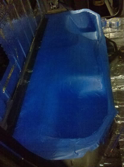

Next I built the frame for the sub box (forgot to take pics, but you'll see it later). I laid all the tape and its ready for fiberglass!!

I measured it to be 1.7 total cubic ft without the subs. With the subs it'll be about .8 cu ft per side. The subs call for .5-.75 each, so im real happy with it.
Fiberglass tomorrow!!
