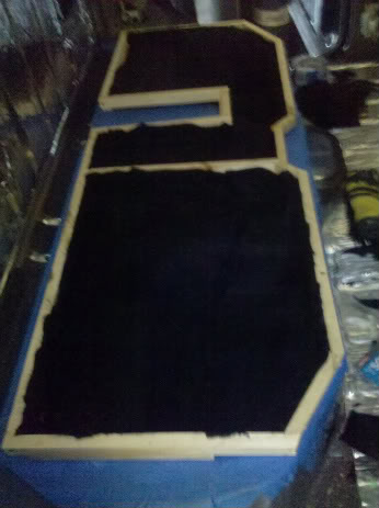

Todays Update:
As mentioned before, I laid the fleece and did the first coat of resin. After that dried (about 5 hrs), I started the first layer of fiberglass mat and resin. This stuff is NOT easy to work with. If anyone has any tips or pointers to make it easier, let me know. I think its turning out pretty good for my first time ever touching fiberglass. I used up the entire gallon of resin for the fleece and half the box's first 2 layers. Im gonna pick up another gallon and hopefully that will be enough.
Im also curious how im gonna keep a good seal when i put the 3/4 MDF on top. Insight on that would be great as well. thanks

The wax on the masking tape just makes it easier to pop the mold out of the truck. The masking tape gets very strong and will pull out your carpet with it. and for the resin before the fleece, that is just to keep the fleece from coming up like you said before. It's like a glue that holds down your fiberglass material. What i used to seal is alot of wood glue, and i also got thin sheets of fiberlass material (what they use for surfboards) but a thicker weave and i fiberglassed the mdf top to the frame from the outside. Then after everything dried, i calked the inside as much as i could. But before that, i laid down some sound deadener. It probably doesn't matter but i had extra so why not.

the resin didnt take 5 hrs to dry haha. The passenger side was actually dry before i finished the drivers side. I left it alone for 5 hrs while i was doing other stuff. Does the resin stick to wood? howd you get the fiberglass to stick to the wood?
Can you tell by the picture how good it is? I'm kinda having doubts about it. Does it look normal?

The passenger side looks good, just super thin. The most important part is to have the fiberglass completely flat against the surface of the floor/ frame. Make the fiberglass around a 1/4" thick. Yes, resin and fiberglass sticks to anything. I just screwed the mdf lid to the frame, then on the seam along the whole perimeter of the box between the lid and the frame i used just one layer of fiberglass buy i also coated with resin beyond the fiberglass. Also, make sure your fiberglass isn't laying over the top of your frame where the lid is going to sit. It looks like your too late but just grab a exacto blade and hack off the excess. The main thing is to just get the box sealed perfectly, so where ever you have doubts about being sealed just add more fiberglass.
