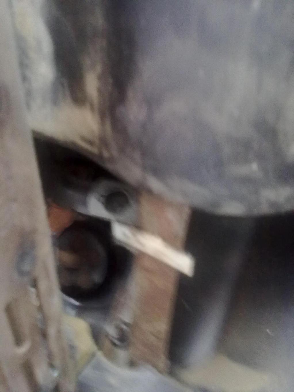

I am actually talking about a 95 dodge Dakota. I looked into it more and I think the switch is missing all together there is a spot where it looks like something is supposed to be I'm thinking it is where the switch goes I took a pic but it wont let me upload it on here.

Ok I guess my computer was acting up here is a pic it's the silver thing there is a hole in it and a part on the break peddle that looks like it's supposed to hit something. Do you know if thats where the break light switch is supposed to be?

I'm not sure exactly on the 95 Dakota. You may have better luck here since these guys know that truck better than I do https://dodgeforum.com/forum/1st-gen-dakota-66/
