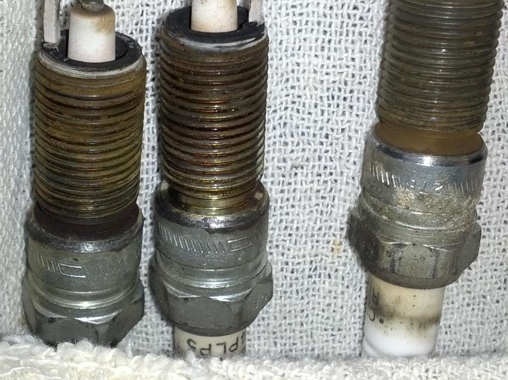

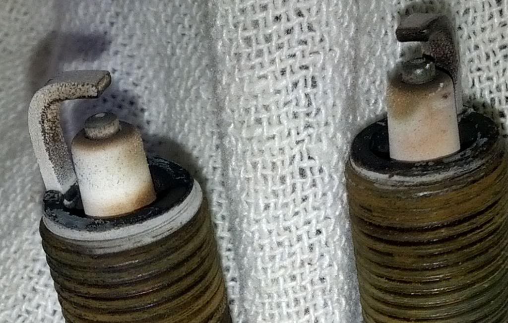

Default Changed The Plugs / Easy Job / Found Some Lose!
I changed the plugs by just reaching back there. No wiper tray removal needed. It did not take long at all. Yes it is cramped, but I am by no means skinny @ 6'2" & 225 lbs.
The hardest part was getting the boots to let go on the rears. I know to be careful what and how to pull on them so it was kind of a pain. Just a little one. The job is not one to fret about.
To my surprise when I pulled on the ratchet on the back ones (1,3, and 5) there was no torque. What tha! The last guy didn't have the arms or ratchet attachments I have maybe. He got the fronts tight enough.
Here are pics. One to show the wear. One to show the seats. The right plug with the nice shiny seat is a front plug. Note how dirty the rear seats are. It felt as if the installer just made them touch.
I always use compressed air to blow around the plugs before removal. After feeling how loose and seeing the seats I did a mirror view and seen no signs of obvious blow-by but mercy sakes.
All of the old ones measured from 0.060 to 0.063. The new ones, five of them, came gapped @ 0.050. One of them got closed a little some how, you could tell it may have been dropped or something. Fixed that.
The PCV valve was a breeze and was a MOPAR unit. It was ready as it did not seal as well as the replacement.
All in all the job does not require a wiper tray removal and the only thing that would have made it needed is if they were over torqued. You don't have a bunch of swing room back there. I used a rehular 3/8 ratchet & 3" extension to loosen. A long handle swivel head 3/8" ratchet to tighten after I seated them with the other ratchet.
Thanks
The Seats

The Wear
