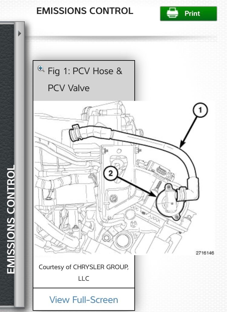

The PCV tube shouldn’t be hooked into the air box - see drawing below from Dodge service info.
There’s only 1 PCV valve and tube but there are 2 tubes necessary for correct operation of the PCV system.
The PCV valve and tube route crankcase vapors to the intake manifold from the rear valve cover.
The crankcase ventilation tube (or CCV) is what hooks up to the air box and front valve cover. This is the inlet for clean, filtered air to flow through the crankcase and allow vacuum through the PCV valve to draw vapors into the manifold.
If the PCV gets clogged or flow is reduced due to sludge build up, the crankcase pressure has to go somewhere, so it will push back through the CCV and into the air box.
#1 is PCV tube. #2 is PCV valve.
