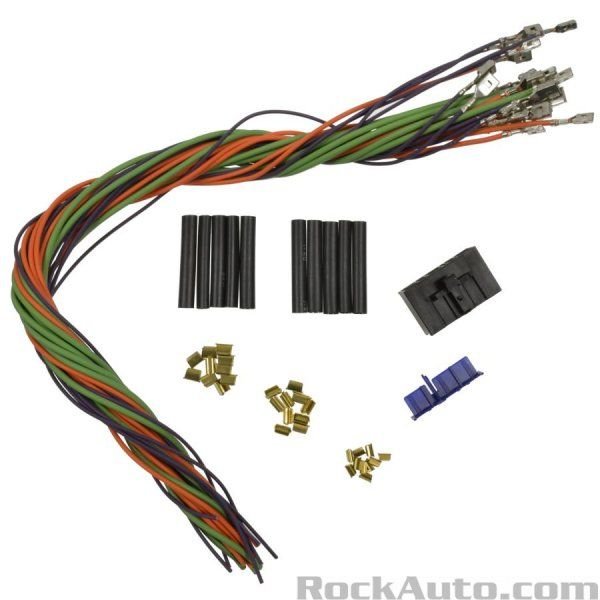

Ok, back to rockauto.com - they show the resistor for the caravan and grand caravan as being the same but for some reason they only list the connector for the caravan. If they are the same, this is at least a starting point even though it’s out of stock at rock auto - you should be able to cross reference the air tex number.
https://www.rockauto.com/en/catalog/...ical-connector

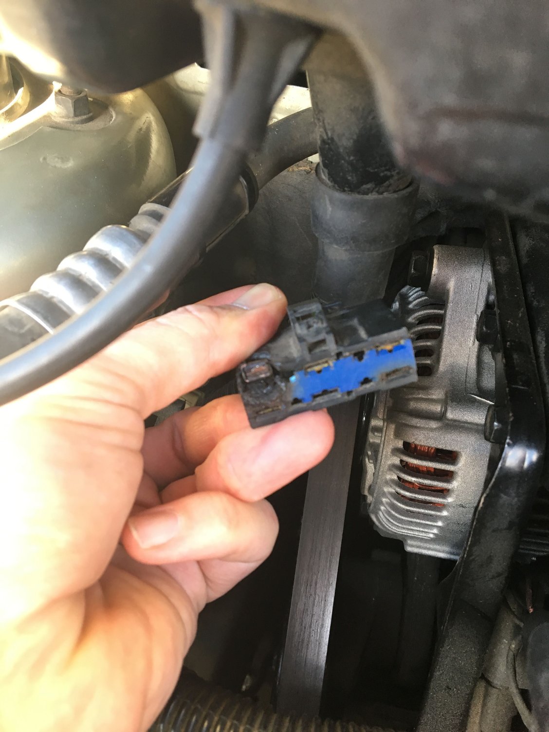

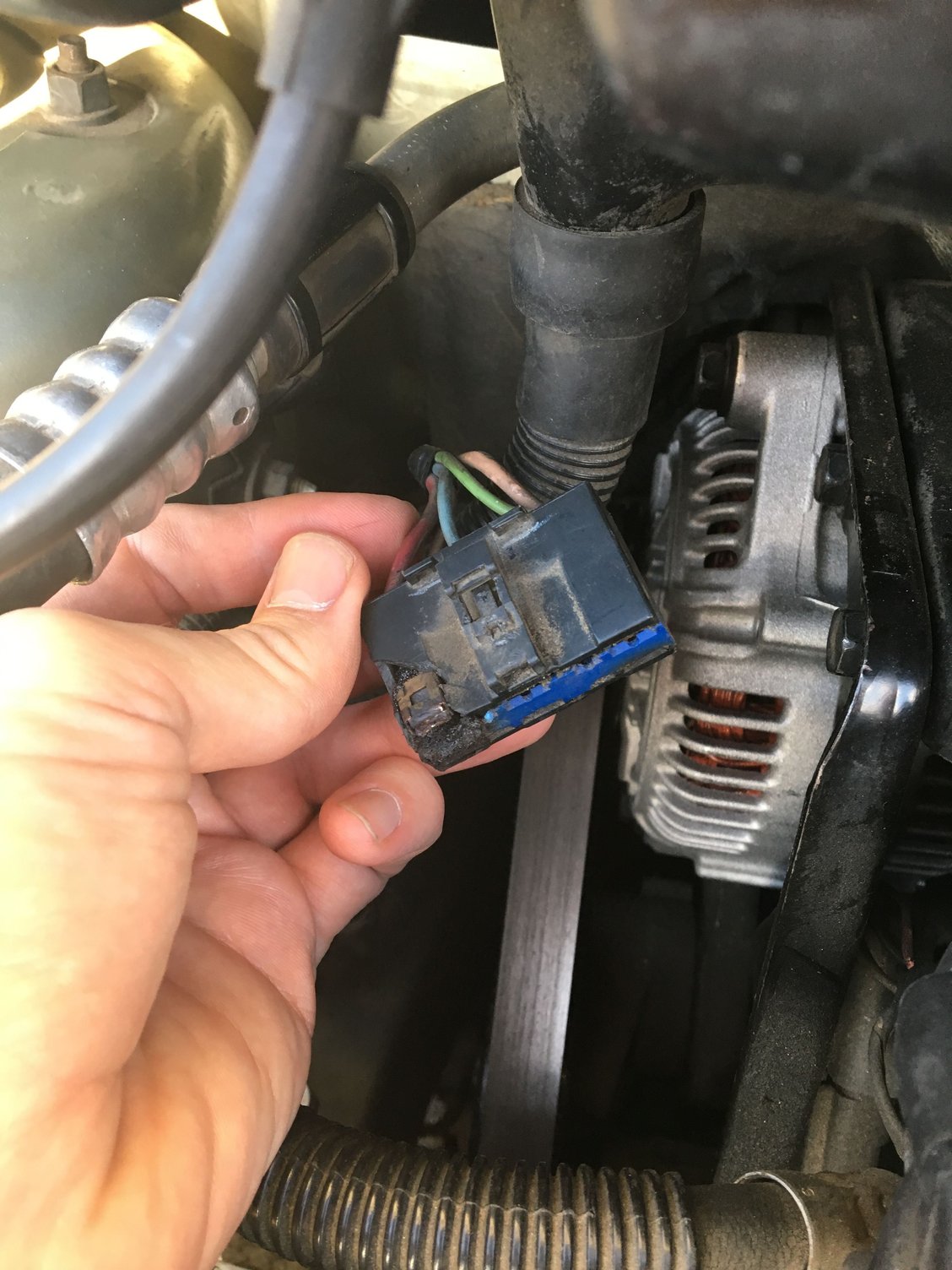

This is a photo of the connector I am looking to replace. I have not been able to find a matching piece.
Old Apr 26, 2020 | 04:09 PM

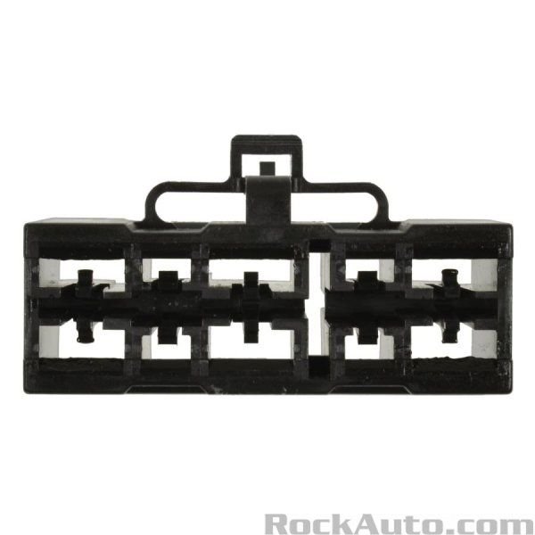

Posts: 3
is this the same piece?
Old Apr 26, 2020 | 08:31 PM
GumbyRT's Avatar
GumbyRT
Joined: Sep 2018
Posts: 553
Likes: 64
Yep - looks right.

Great picture, I didn't think anyone else other than the dealer would have the kit.
