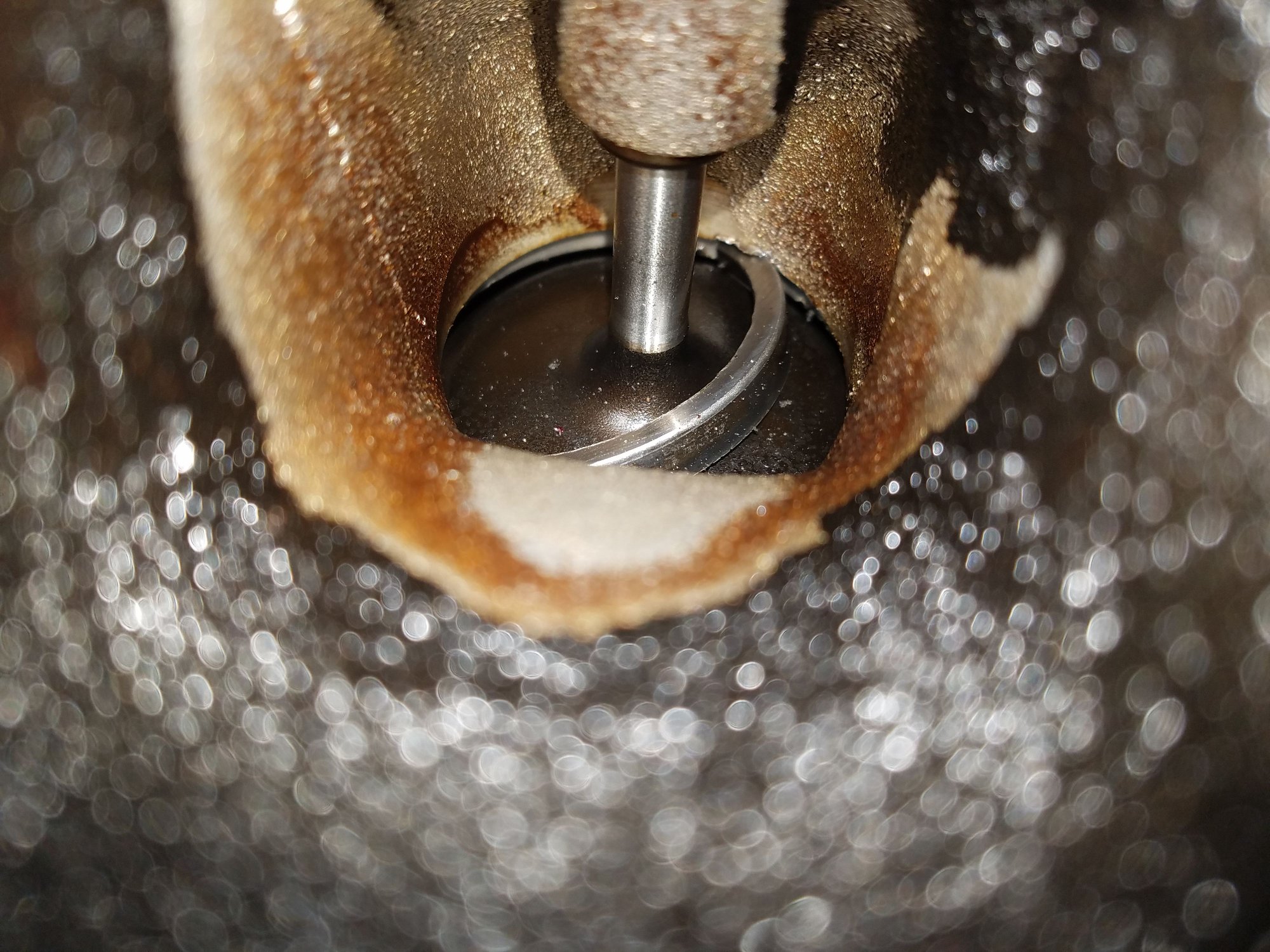

Old May 16, 2018 | 08:33 PM
clong's Avatar
clong
Joined: May 2018
Posts: 5
Look at what i found
Old May 16, 2018 | 10:22 PM
Posts: 87,468
Likes: 4,221
That'll do it........
Old May 17, 2018 | 11:03 AM
HemiLonestar's Avatar
HemiLonestar
Joined: Nov 2005
Posts: 3,739
Likes: 8
From: MD
At least it stayed up and didn't go say hi to the piston crown...
