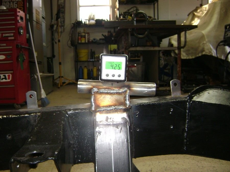

This IFS will be the death of me. I struggled for hours the other day trying to make sure everything is right. The cross member appears to be square and level. I installed the control arms, and the lowers are level at ride height. So, the upper ball joint should be behind the lower, and the angle between their centers should be about 4 to 5 degrees of caster angle. I am using a manual steering rack just in case anyone wants to know. If it was power steering, I could add a little more, maybe 6 or 7 degrees. Then the upper control arm pivot point should be set at around 5 degrees for anti-dive. The drivers side is set, and looks to be going okay. The passenger side has just made a mockery of me. Ill deal with it again saturday, and maybe have more information. The more I look at it, the more I notice little things, Like the lower control arms are nor perfect mirror images of each other. I am trying to avoid cutting the whole thing out. I think Im going to build in some extra adjustment points so I can make sure this thing is aligned right when the time comes.
In the mean time to boost my spirits and confidence, I started the cross member pass throughs, and started filling holes. I think Im going to remove the crooked cross member (I think it was for the carrier bearing), and add the new one I made. Actually, Im pretty sure its too tall, Ill have to make a shorter one, But I like it, and itll look good under there.
Everything is straight and level. This side went okay. I can still hear the other side laughing at me.
Bad picture, but it shows the anti-dive angle. I just have to make the other side match perfectly.

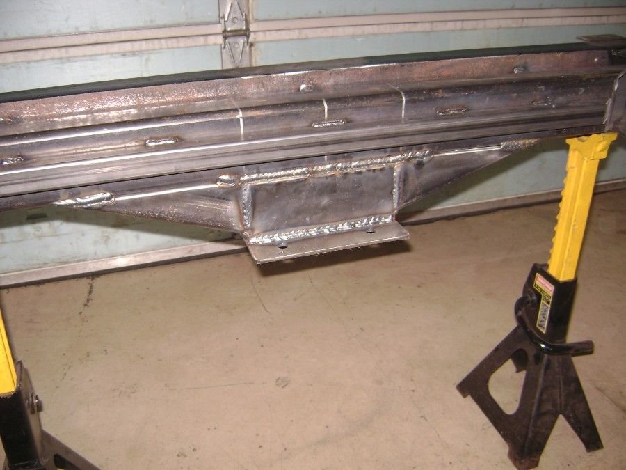

Back side of the pass through. It will get welded and smoothed.
Front side of the same one. Again, itll all be welded and smoothed.

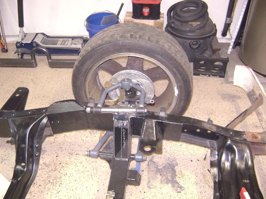

I decided to put my head down today and either fix this, or make a decision. I think it turned out great. My welds are still lacking a bit, but they are burning in nice. They arent the straightest, and my speed still needs work, but this isnt going anywhere. I measured and remeasured and everything is within 1/16th on the tape measure, and the angles are all well within 2 tenths of a degree. The upper control arm mount angle (anti-dive, what started this whole problem) is within 5 hundredths.

Everything is nice and level. Except the bumper apparently.
Side profile. They match pretty good I think.

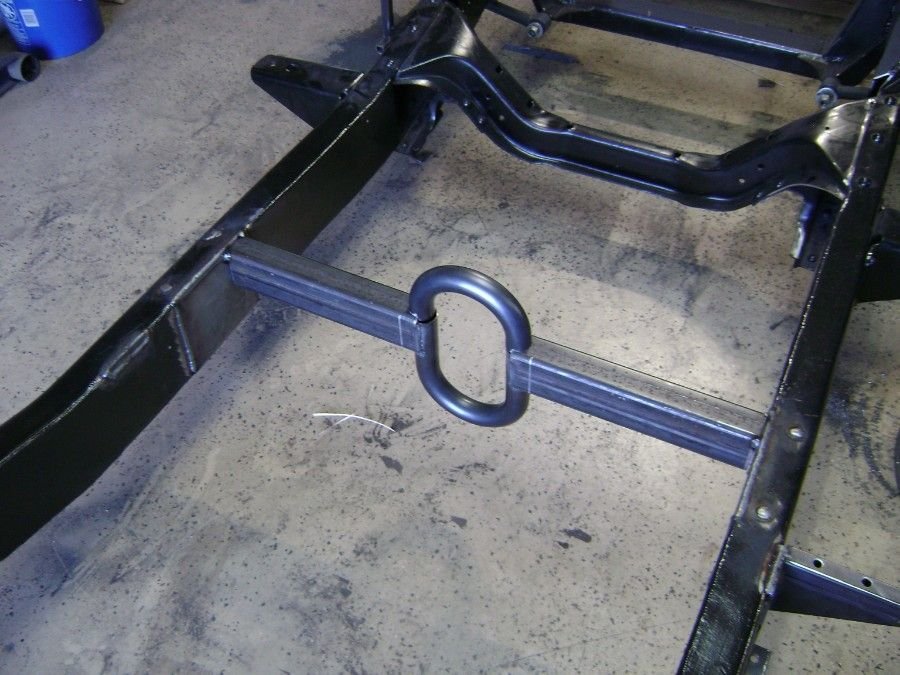

I removed the carrier bearing cross member, and welded in the boxing plates. Then I tacked in the cross member I made...and its not going to work. The short story is, my wife loves driving my Charger R/T. This started a discussion about the future engine we are going to put in the truck. I explained the cost of installing a 5.7 hemi, with a T56, and the benefits and we talked about it for awhile. She agreed it would be worth it, if we can afford to do it in the future. So, thats going to be the direction we are planning to go. So, the T56 will be quite a bit longer than the NP435. So, Im going to remove this cross member, and weld in some angle down the sides of the frame. Then I can bolt in a cross member. When the time comes, I can remove or relocate the driveshaft loop, and add a tail cone mount for the T56.

I still need to finish the cross member pass throughs, but I wanted to get some other things going first. When I get all of this finalized, I flip the frame over and weld everything from the bottom too. Then we can paint the whole thing.

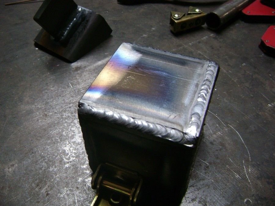

Practicing TIG. At least Im not dipping the tungsten every three seconds now.
Last pass of the day. I went from right to left, so it started out pretty good, then got ugly at the end.

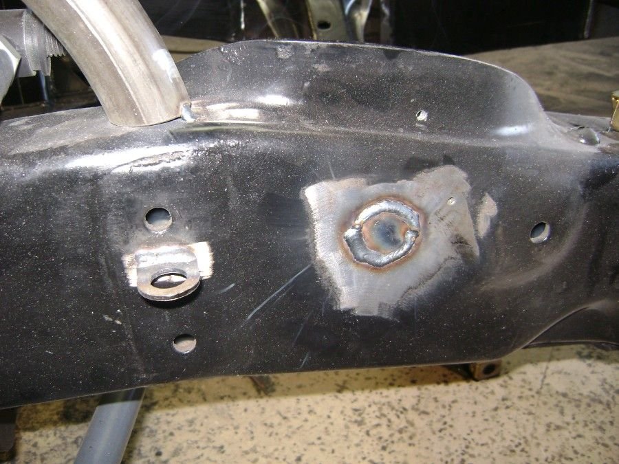

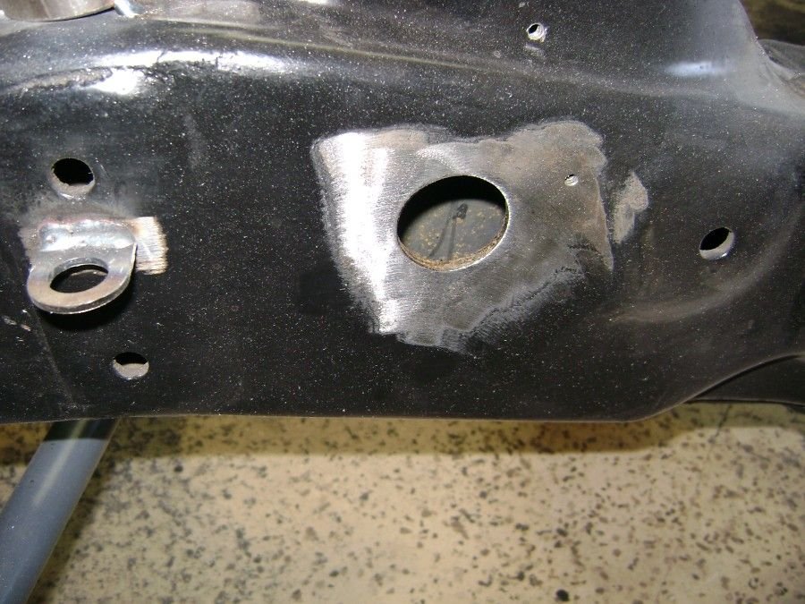

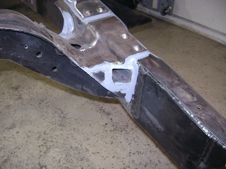

Big hole for the steering box, I think
Small plug from 3/16" plate
Weld it up....
Grind away.

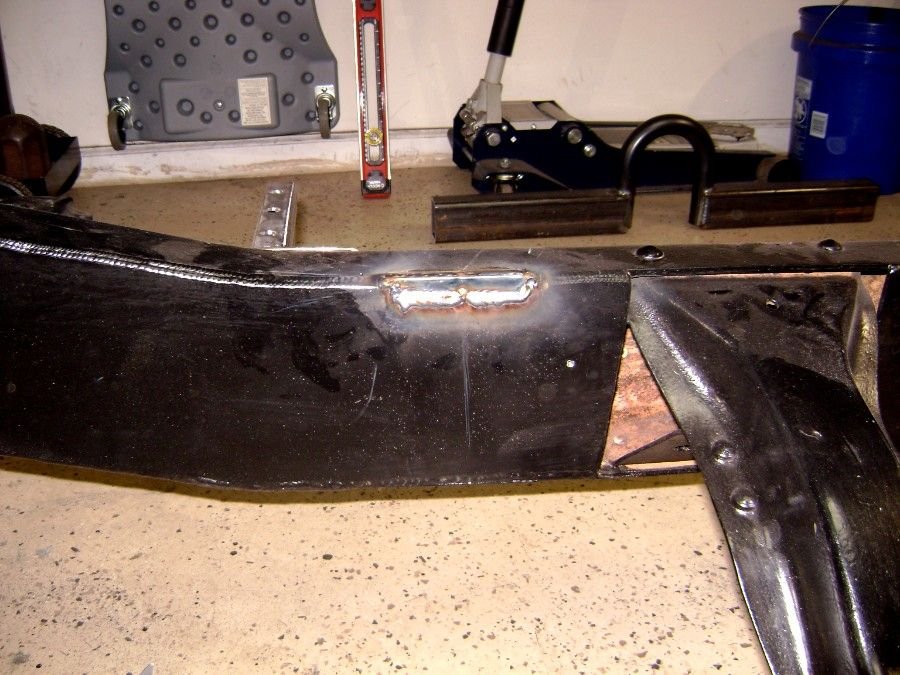

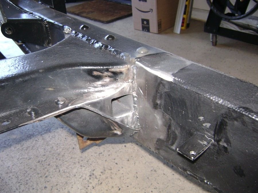

This is the back side of the drivers side pass through. Its under the drivers feet.
Front side of the driver side rear pass through. This will be under the bed on the drivers side.

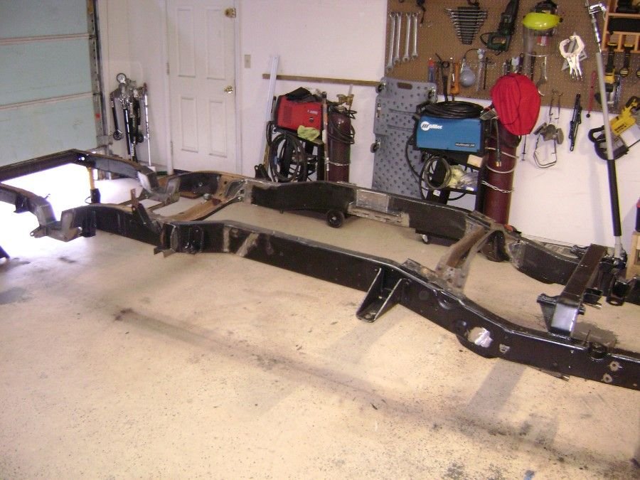

I have been busy cleaning the frame. Not a lot of pictures, but it is a lot of work. I have swept up probably 4 or 5 dust pans full of dust, rust, cut-off wheel debris, and all sorts of nasty stuff. Its a mess. I think I am finished now though. I got the frame flipped over, and finished some of the welds on the bottom because Im not good enough to weld overhead without screwing it up and burning myself. I have wire wheeled the whole frame, and actually scraped all the grease off of it. I finished the pass throughs, and the hitch mount. Ill post more pictures when its painted and ready for re-assembly. Im going to use some seam sealer and smooth out some things as I go. It should look pretty good.
Flipping the frame over was a bit sketchy. I got it though.
Flipped and ready to make a mess. Ill show more details when its painted.
