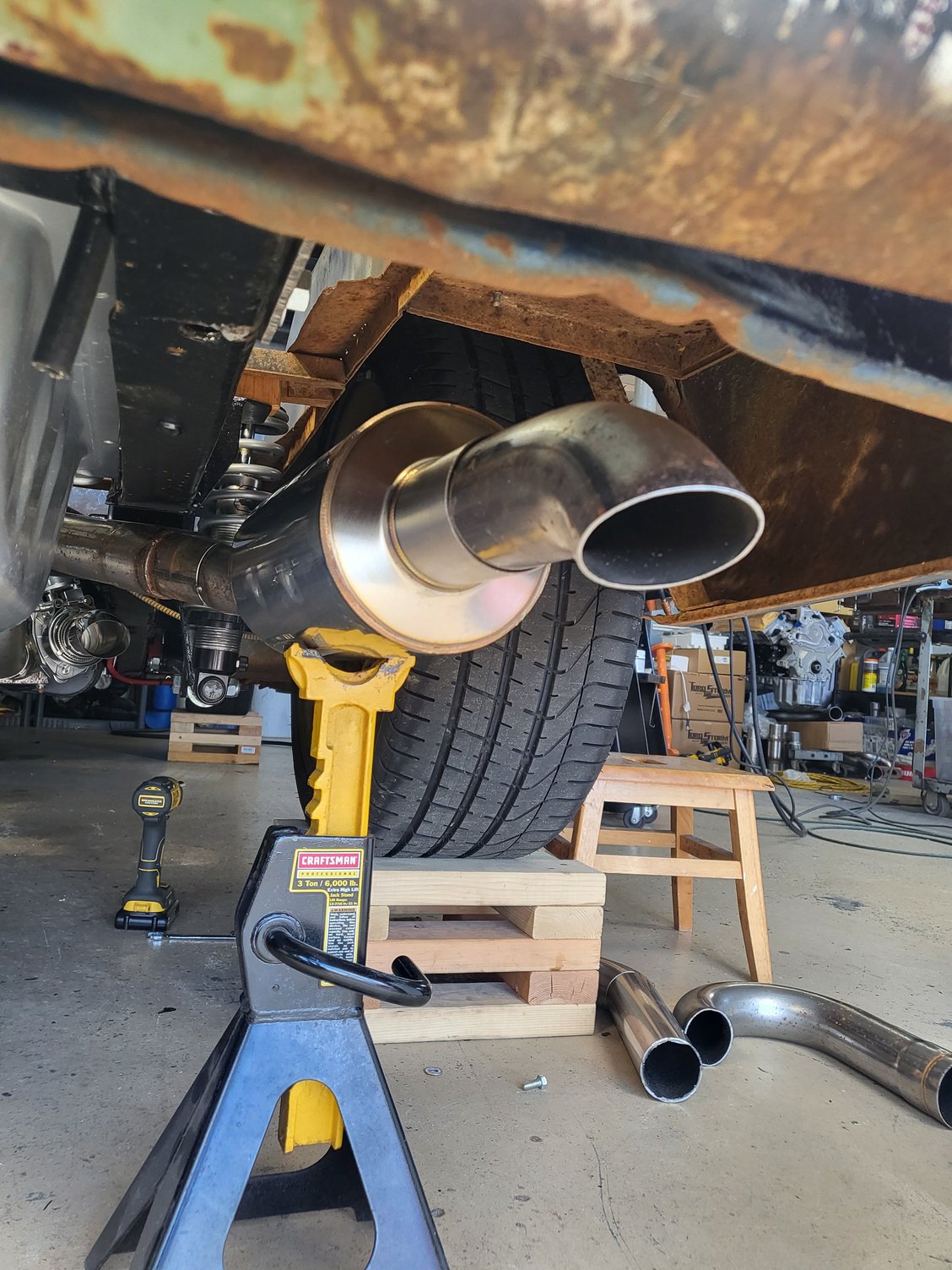

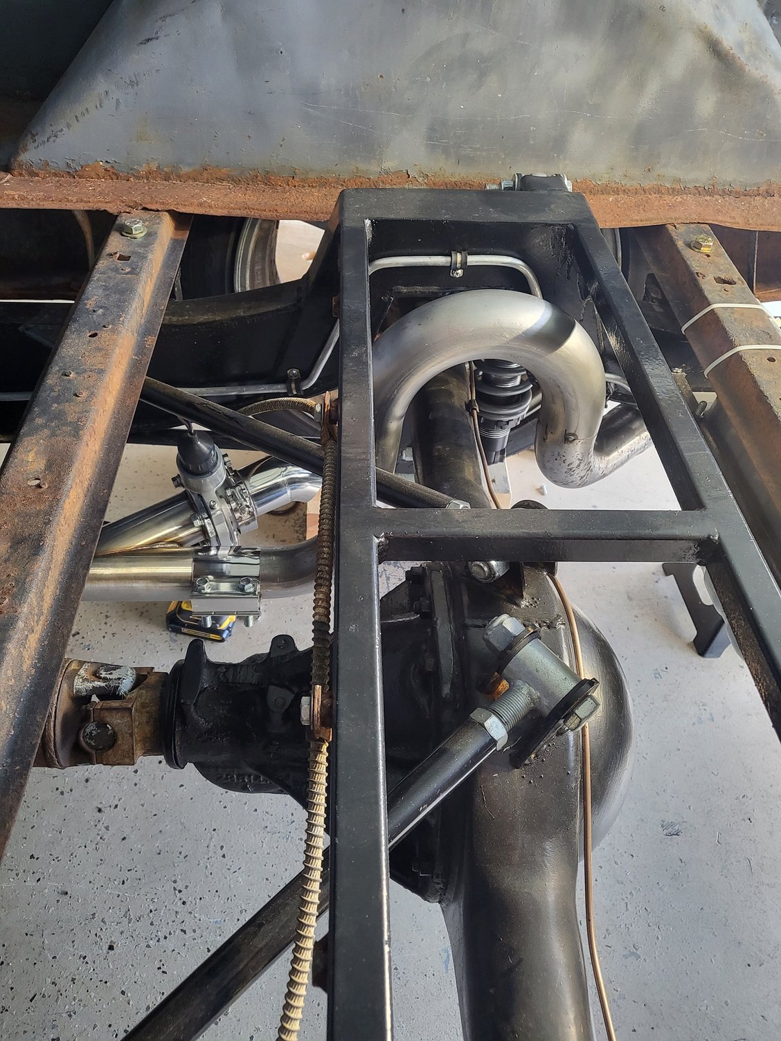

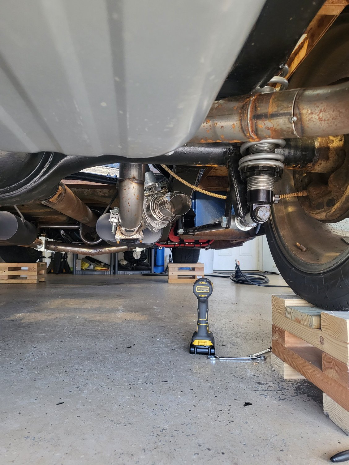

Started working on the exhaust and fuel injection upgrade. I am adding some cutouts and resonators to tone the exhaust down a bit. I plan on driving the truck, but when its 5 am I dont want to wake the whole house. Plus some towns have noise laws, and I dont want to draw attention, until I want to draw attention. I had to move the mufflers forward about 2" to make room for the cutouts. Then the angle was off, so I had to re-do the part that goes over the axle. I have one side where I want it. I have to order another J-bend for the other side.

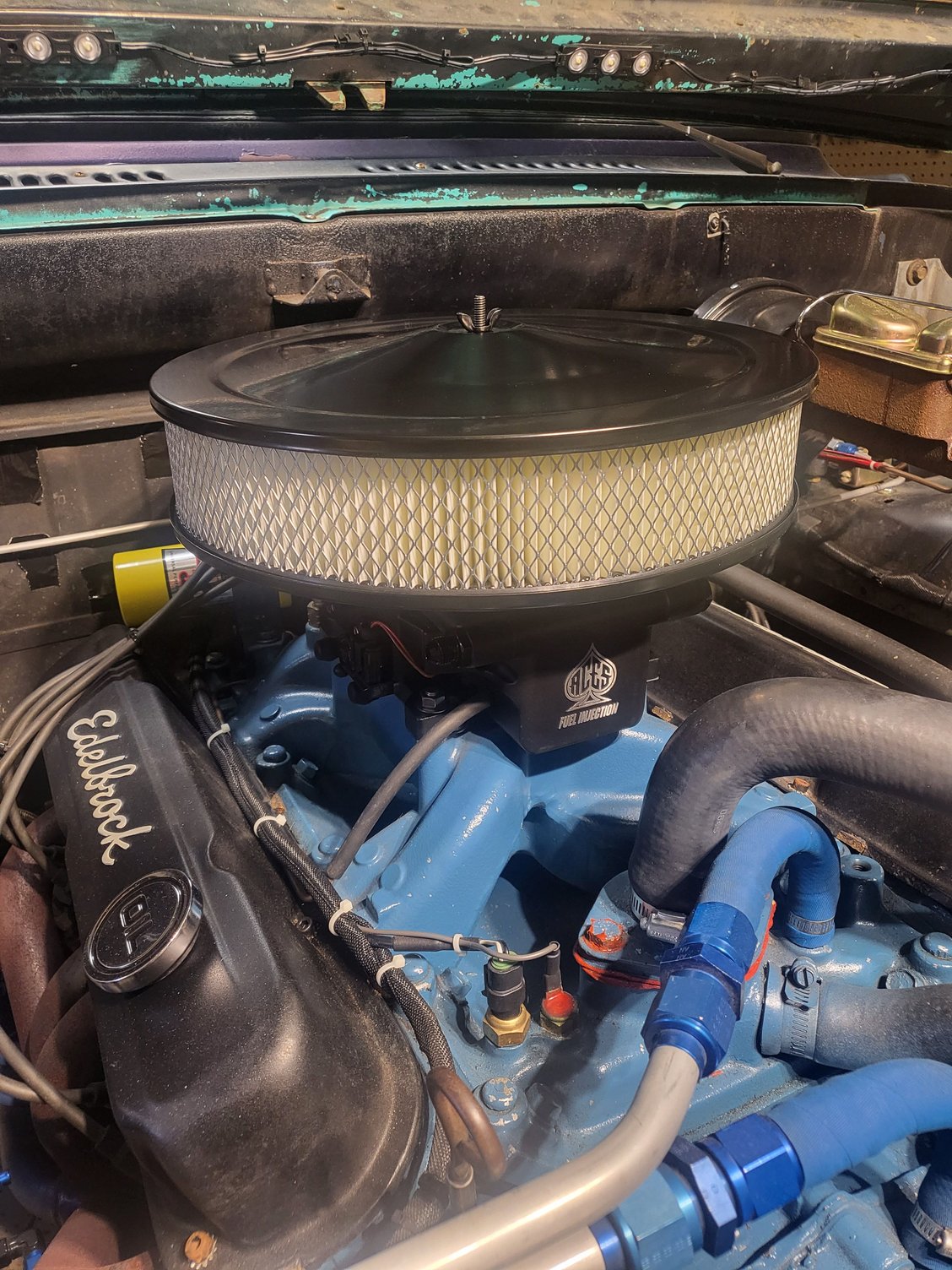

The EFI looks killer on the engine. I love the way it looks. The Aces Killshot is a newer system, but they had some good reviews, better than the FItech, and even the Holley which was much more expensive. Plus they are out of Tennessee, so I had to show them a little love. If looks and presentation are any indication, it will work great. I also got most of my fuel system components. Now Im down to the fittings and lines. After I finish the exhaust, and the fuel system, Ill wire it all up. I also have the new, longer column painted, but I dont know if Ill get it put in this winter. We will see. Im working 60 hr weeks at work, and there isnt a lot of time after that to work on the cars.
The cutout and new over-the-axle section. When open, the exhaust will dump right at the cutout.
View from the back. Ill have to add a few more hangers also.
The new resonator. I hope its super quiet. Thats what I was going for.
New EFI from Aces, and the 14" air cleaner. I might swap out for a K&N eventually.
It looks great. I could have got it in gold also, but I thought the black worked better.

Looks like a holley four barrel. Wonder if this was the idea.

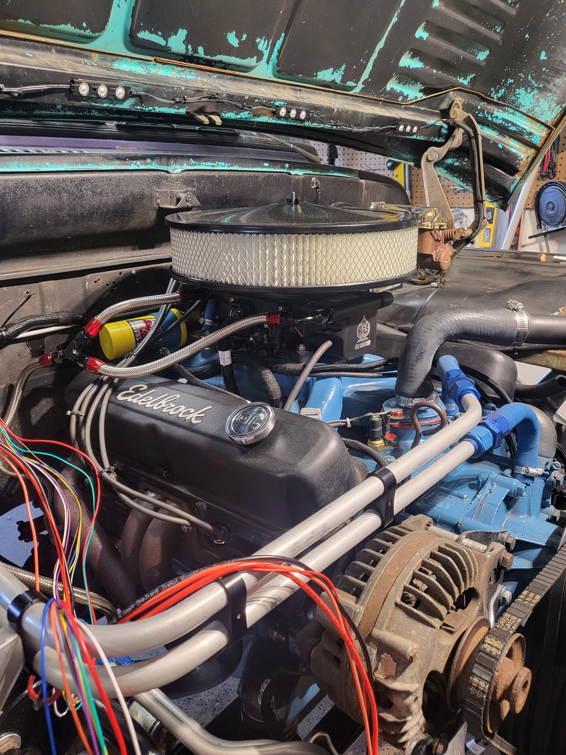

Here is where I wish I had planned better in the beginning, because I wanted to mount the ECU under the dash, and keep the engine bay as clean as possible. But, I dont have a lot of room. This truck has some weird shapes and angles too, so a lot of the room is unusable. Had I known I was going to go with the fuel injection, I would have planned it out better. It will work, but the engine bay is starting to look cluttered. There are tons of things I would do different if I could do it over again, but Ill probably never get the chance. After this Im working on my car for awhile. Maybe in 10 years, I can go ahead and build a frame for it like I want, and do it the right way. We will see.
Anyway, pictures. Im not done with the lines. Fittings are in the mail.
I almost forgot, I had the new longer column painted. I might put it in while Im doing all this wiring and fix the turn signals, horn and hazards. I dont have pictures of it, because it all wrapped up. I dont want to scratch it.
Fuel pressure regulator. I wanted this on the firewall, but the heater takes up too much of the space, so it has to go here.
ECU and the relays. Ill work on the harness and make it as clean as I can. It says it can be mounted under the hood, so it is water proof.
I just started the wiring. I plugged everything in, and dropped it in place. Ill work with it. If it gets too bad, Ill shorten the harness where needed.
I dont remember if I have shown this, but this is likely where the screen will go. It doesnt interfere with the shifter, and its out of the sun too.

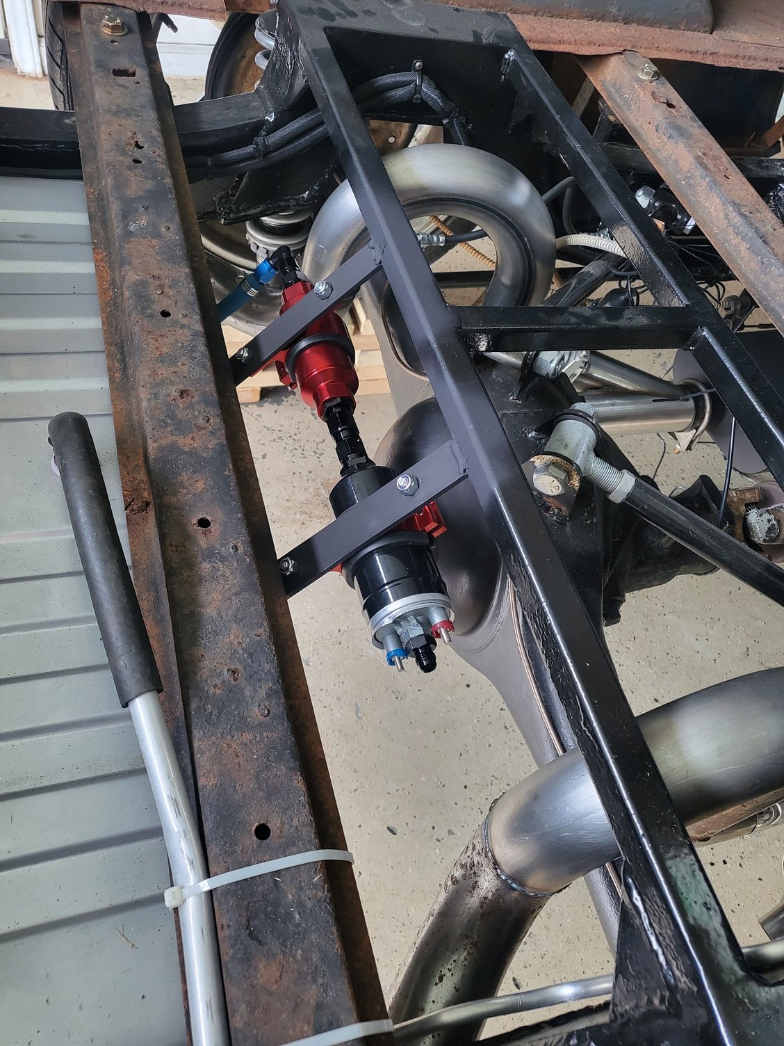

But anyhow, I managed to get some brackets made and welded in for the fuel pump and one of the filters. I also made a small throttle cable and spring bracket, but I didnt get a picture of it. Im going to have to reroute my battery cables I think. They are going to be in the way of the return fuel line. Ill have to take a closer look at some point. But for now, I have the pump and filter in, and they are far enough away from the exhaust that Im happy with them. The pump is above the fuel pickup by a few inches, but I think itll be fine. Ill have to run the hard line for the return also. And Ill have to make a few more lines to tie the new pump and filter into the system.
Pump and filter. The bracket is welded top and bottom to the frame.
Fuel lines. I will find a way to secure them to the firewall and engine.
Next will be wiring. I still have to weld in an O2 sensor also.

That fuel line looks real close to the header!
Old Nov 12, 2023 | 03:34 PM
  #309
drummerdad's Avatar
drummerdad
Joined: Jan 2016
Posts: 253
Likes: 10
It is. I'll have to reroute it slightly.
