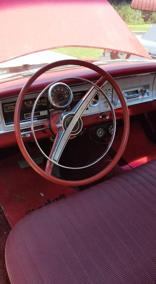

I pretty much posted pics in the beginning of this thread. Im replacing the entire ignition system, so no need for pics of that....but.....here's a couple pics of the interior that I didn't post yet...
Old Sep 7, 2020 | 01:16 PM
Posts: 87,572
Likes: 4,233
Where are you at? That car is in REALLY good condition for its age.
