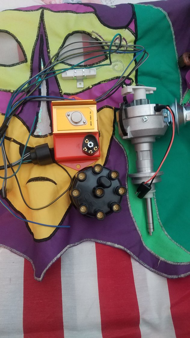

Hey...back on topic here for a minute....I got my new electronic ignition kit yesterday. Dumb question....does it matter what position I mount the orange ignition box as far as vertical or horizontal?? Looks like I will have to mount it in a horizontal position to catch the existing firewall holes. (I am referring to the mount holes in the ignition box)
Old Sep 15, 2020 | 04:10 PM
  #38
Posts: 87,483
It doesn't care about orientation, so long as it is bolted/screwed to metal, (that's how it grounds....) it'll work just fine. (running a separate case ground for it wouldn't hurt either.)
I like to mount where there's air flow. Other than that, the box doesn't care. Like HeyYou said, be sure to ground it. I usually put a dab of dielectric grease under the case as well as a dedicated ground wire.
