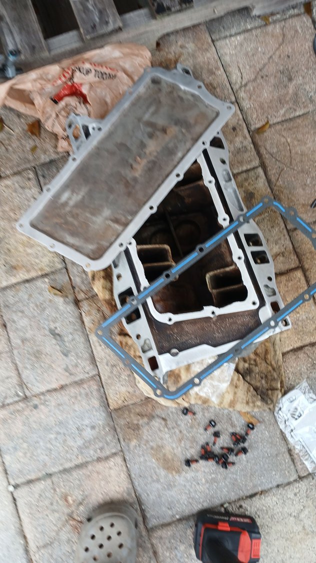

When I was taking off the triangle bracket for the compressor, the bolt broke off in the hole. Then while trying to get it out, the mounting hole cracked...then I tried to fix it...while trying to drill it out..I slipped...and screwed it up :lol:
I went to the boneyard and found a Durango with a 360. I pulled the intake and it looks exactly the same. I got it for $40 - with injectors...
I have it back here now and everything lines up...but the part number is different. BUT the injectors are very different (so I will have to swap those)...Nothing else is as far as I can tell.
So it should work - right?

Yep. The intakes changed over the years, early ones supported EGR, later still had the center divider, but, lost the EGR stuff, still later ones lost the center divider altogether.

awesome...after some Foamy engine brite all over the intake and swapping the injectors over, along with the two sensors...then Ill be ready to put this back together once i get my lifters this Friday.
Question - can I soak the intake in CLR too?

Oh my FFFFFF God - what is it with the gaskets that were on this intake I pulled from the boneyard...
I could not scrub them off...scotch brite pads were too tiring and almost usless...
I ended up having to use my sander...it worked great
So I finally got the Durango intake refurbed and swapped my sensors and injectors on...tomorrow is lifter day! Cant wait to put it back together....
