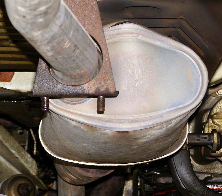

And in looking underneath to see about this fuel filter I noticed:
Muffler bulging. It even looks like there's a split in the top of the crimped area there. I've had no backfires, so this is old damage.

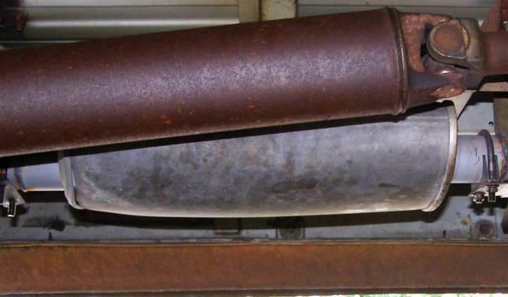

Side-on/ You can see here the bulge in the thing, it's a wonder it wasn't blown right open, it seems.
There is a possibility, of course, that the outlet to the pipe is partially blocked, which could account for some of the poor performance.
But why is the thing shaking its head off under power now, something it didn't do before? And seemingly heavier on fuel than ever...
