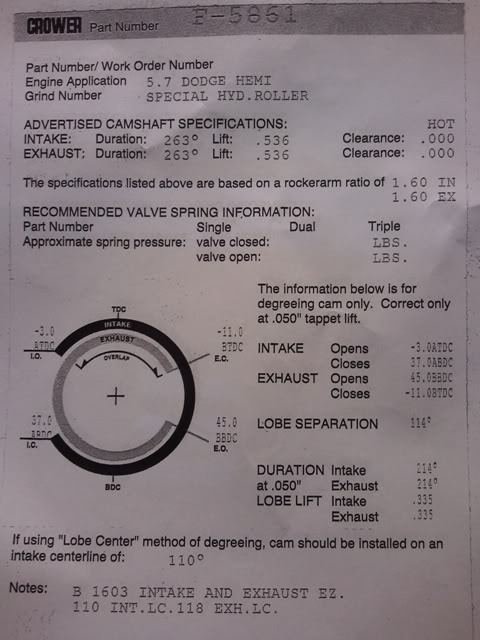

Greg. copy of Cam spec sheet I got. Not sure what the RPM Max range is. Did a few 100 Mph Pulls in normal "D" with 5800 (approx) shift and it pulled hard. I will try 6K next time and shift manually as the RPM limiter is still set at 6400 from when the 6.1 was in.

I'm back on line now. We had a bit of tyhpoon come through and knocked everything out. I thought you had the cam ground on 114 centers? Are you idling ok with that cam. The spec sheet looks pretty aggressive to me.
Idle no probs - 600 on the Button and never stalled once.
See Lobe Separation at 114 as per the sheet. Normally the Crazy is at 113 but for the 03 STU recommends the 114 as it is proven to work well when using the SC programmer.
Aggressive?? Imagine that Spartan Grind on a 117, I was talkin to you about, but then again it was put in an 04 (KG's).
