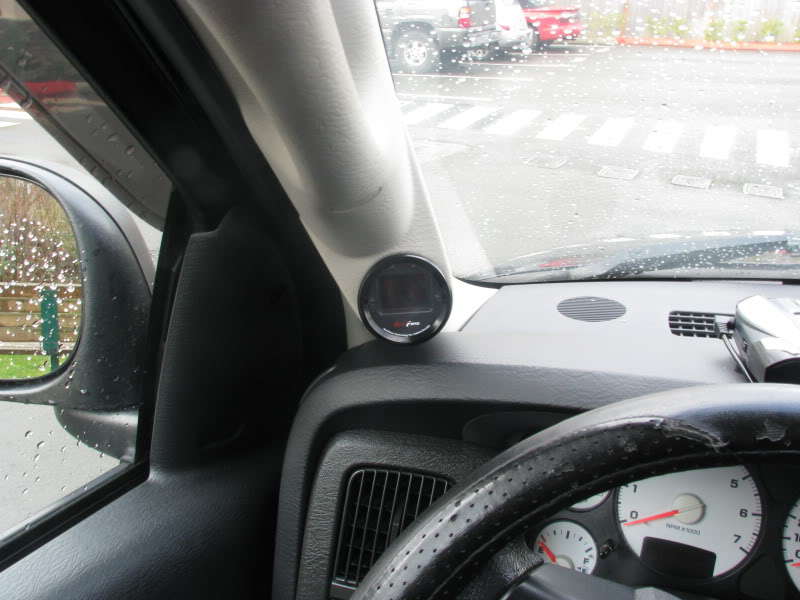

buy the Interceptor gauge, you'll love it. It's pricey when you add in the A/f option but the gauge monitors everything you need so conveniently. Well worth it in my opinion, I love mine and highly recommend it. I'd also recommend getting the SRT10 A-pillar as well.

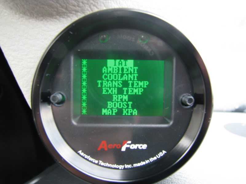

Here's a small list of the many options you can choose to monitor.
