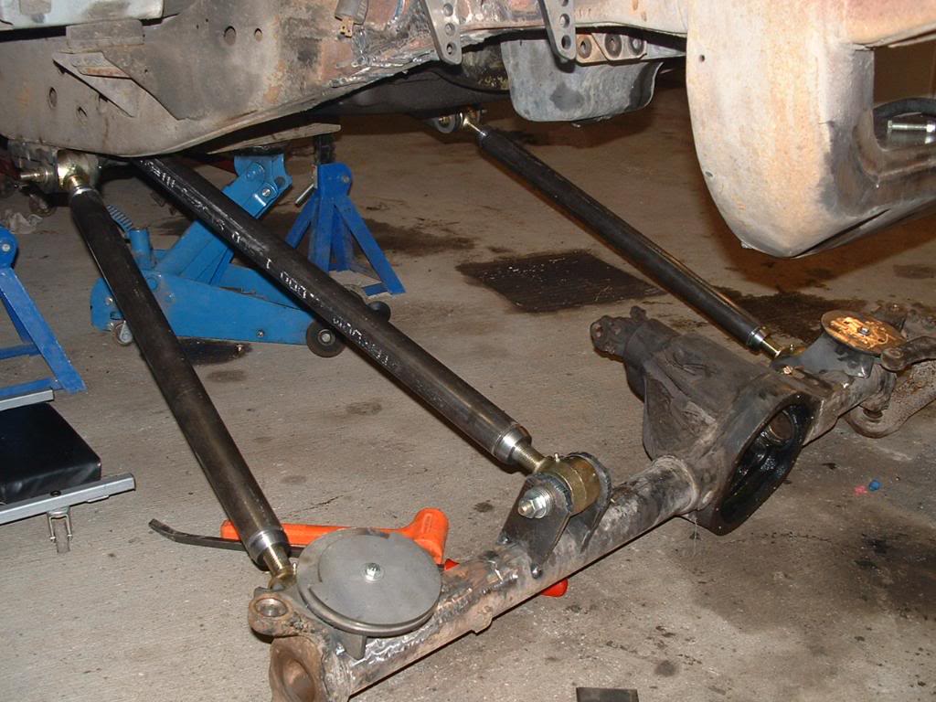

I did decide on a new design for the front based on another build I was given the link to a few months ago. Its a simple 3 link with DOM tubing and Johnny Joints. Here is a picture...
Here is the link to the thread...
http://www.pioneer4wheelers.org/foru...-the-trail-rig!

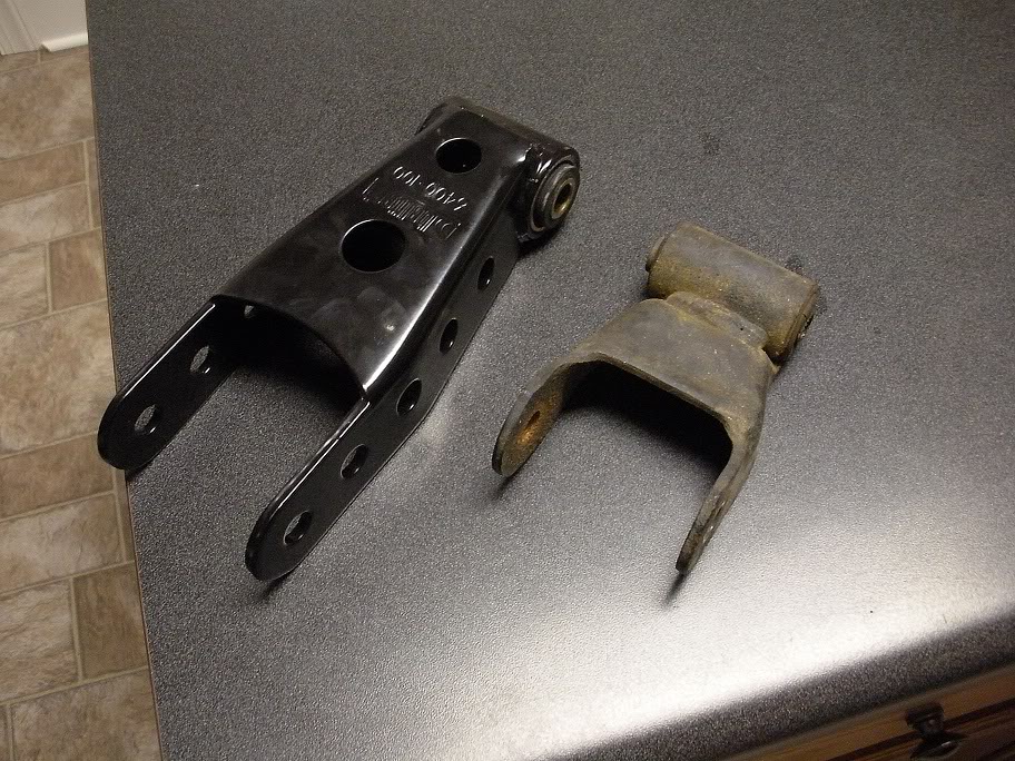

Got my new shackles today!! This ought to give me some lift...

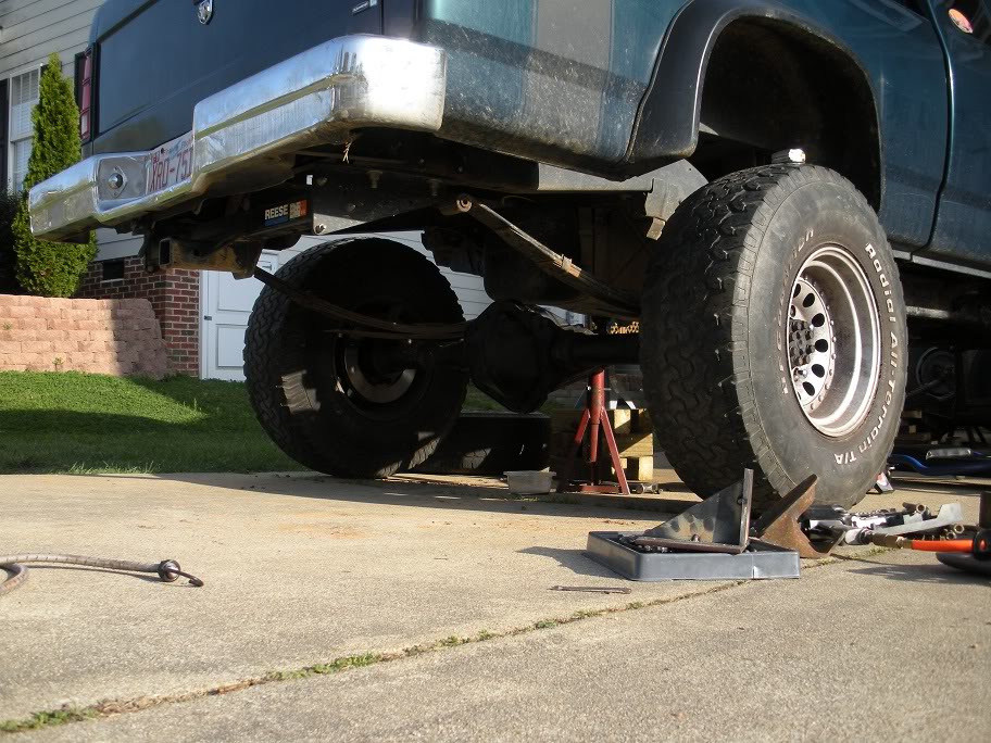

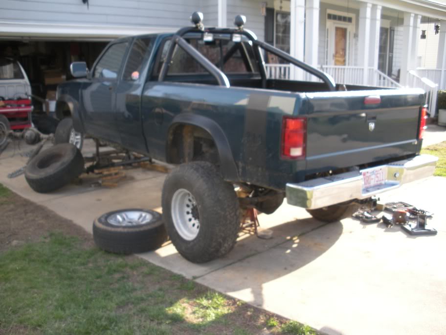

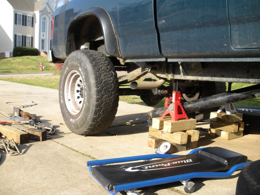

I got the 9.25" out from under my truck today and rolled the 14 bolt in place. Here are some teaser pics of the 14 bolt under the truck...
I have yet to make a set of hangers that I'm happy with, but as soon as I get them done I can get the 14 bolt installed with the F150 leaf springs.

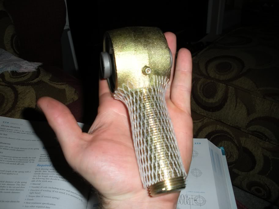

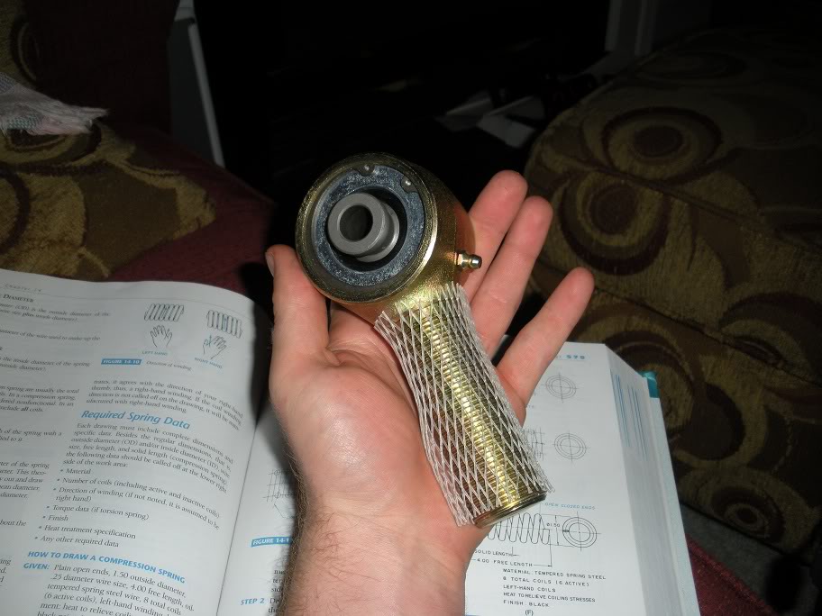

My 3 link materials started coming in today. Hopefully the rest of it will show up tomorrow.
Here's a couple pictures of the johnny joints. I think they ought to get the job done!!
