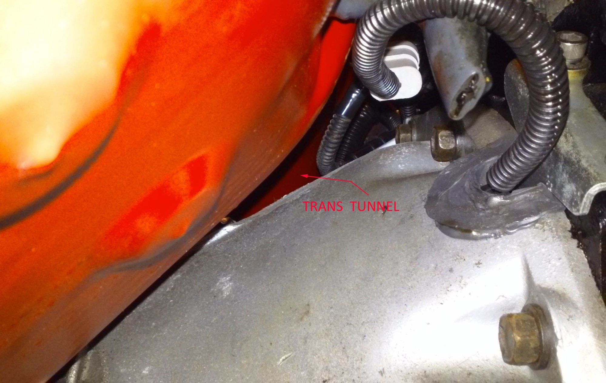

I tried to get some decent pics, buts its actually difficult to get a perspective that tells the story. Here's what I got though. First pic shows the bottom of the trans and engine in relation to the cross-member, which is maybe 6"-7" wide and has the sway bar running through it. To clear that cross-member you have to pull the trans straight back maybe 8"-9", and that's what concerns me. You can kinda see in the next picture how close the bell housing is to the cab. You can't see inside the tunnel unfortunately, but going straight back 8"-9" looks like it would hit, to me:

Looking at your pictures, I cant imagine it sliding in......... Even with the motor out of the truck, I wonder if it would all go back together with the core support in place.

Also, thanks again for taking the time to post the pictures for me.

With the motor out, the NV3500 will slip in from the engine bay, I can attest to that. Just so long as you don't try it with the transfer case attached. I really think 3" of lift on the cab would be enough to slide it in or out from underneath too.
