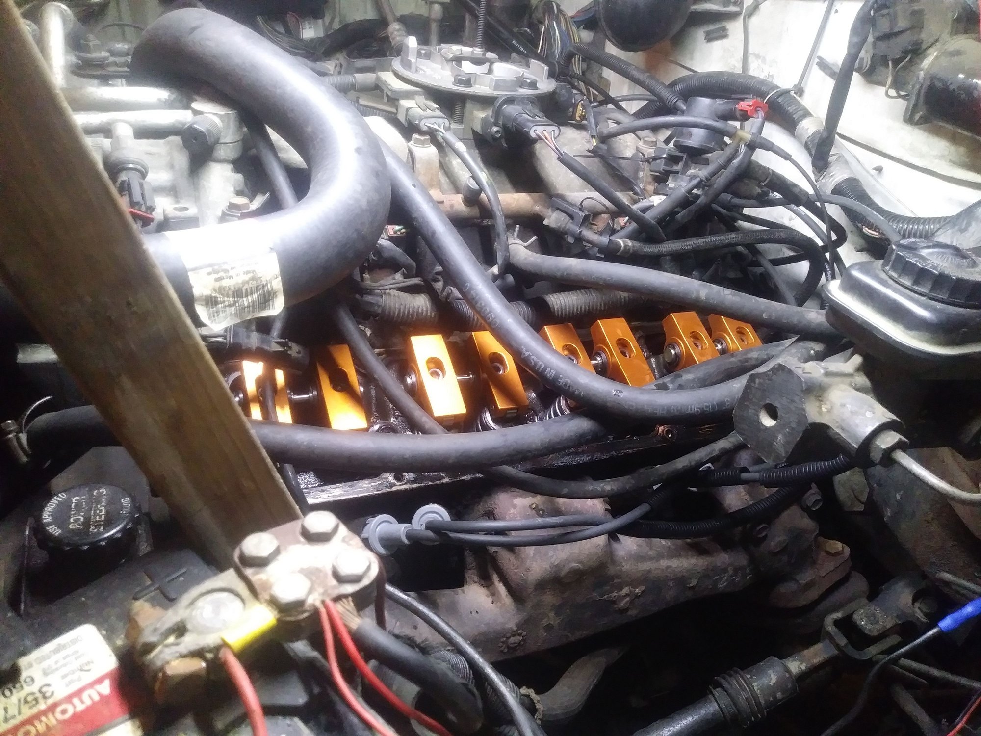

Whatever floats the boat. But I promise, its a waste of money..
naturally the pic won't load. Guess it did. Twice maybe even. Theyve been in for at least 2 oil changes, and there's nothing in the oil and everything is smooth as can be. Great value, especially when you get them straight from Harland Sharp.
