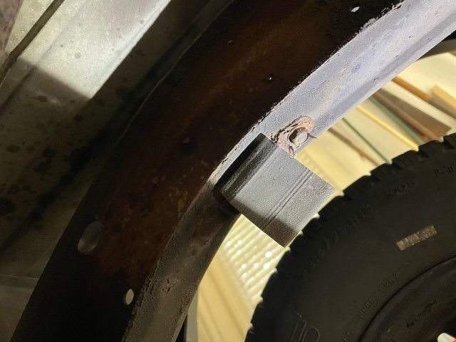

I am missing my left side rear axle bumper. All that remains is the bolt. Here is a pic of the right side rear axle bumper that is still there. It's a one-bolt design. The other end clips in a hole. The bumper itself is chisel shaped. No flat spot at the tip (pix doesn't show it sadly). The hardware on this one remaining bumper is pretty crusty so it's probably not long for this Earth either. I gave ES a cursory glance and did not see this one. Found a Mopar p/n 52038682 but I believe it said it was for 1997ish and newer and not even sure it was for the axle (not to mention pricey beyond belief). Looked like maybe it was hollow. So I have more searching to do. Have not checked the FSM or parts catalog yet.

Snubber is P/N 3722996 - they do show as being current stock on a quick Google.
You may want to check its dimensions against an Energy Suspension or Prothane universal too ... ES pages 2-6-final (teamenergysuspension.com), page 10, and look at 9.9137 and 8.9102 specifically. (You'll need to use a bolt on that side that's currently just hooked).

Dang, you're a parts hound!
I like those 9.9137s. Confident they would do the job, affordable, easily available. I was able to extract some dimensions off the questions section in Amazon so I'm going to check a little later for fitment. Would think I could use the hook slot to run the second bolt thru. Just washer it up good. If not, maybe just a little carving.
I'm gonna assign a part number to Brian Laundrie and get you a job with the FBI. Who needs milk cartons!
UPDATE: Checked bolt holes on frame. 3" center to center. If the dimensions the dude on Amazon cited are true (4-9/32ish" calculated on centers) then I will have to drill one hole in the frame (figuring I can use one of the existing holes on the frame). In looking at it, I think I have enough room to get a drill in there but it will be a little tight. That or maybe I can MacGyver it with a beam clamp or sumpin.
