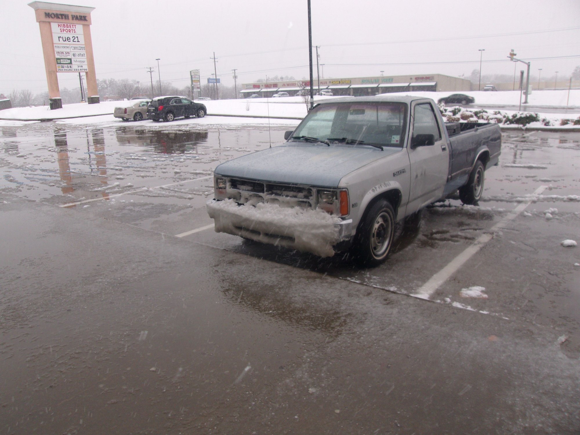

BTW, I still have not seen a photo of your 88. Is it an extended cab (did they have those in 88)? Assuming a V6 LA or A?

Heh.
No, they didn't have the extended cab. It is a long wheel base, with the 8' bed.
Picture ...
This is from a few years back, not during Snowpocalypse 2021 but a previous heavy snow fall in this part of the country.
I've added a camper top to the back since, about five years ago. Also now have some Jeep Wrangler wheels on it, powdercoated a satin black. I have the center caps, need to clean them and paint them, then put my ram's head logo on them.
He's not much to look at, but he goes every day.
It's the 3.9 LA, yep. A998 3 speed auto. 2.92 rear end, 8.25" gears, 10" rear drums.

I'm impressed! Snow crap notwithstanding, it looks like it's in pretty good shape. And considering the mileage there doesn't appear to be any major battle wounds on it. Nice!
