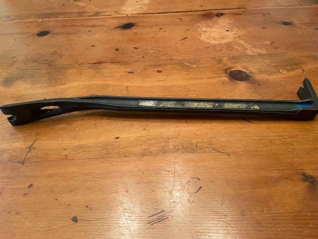

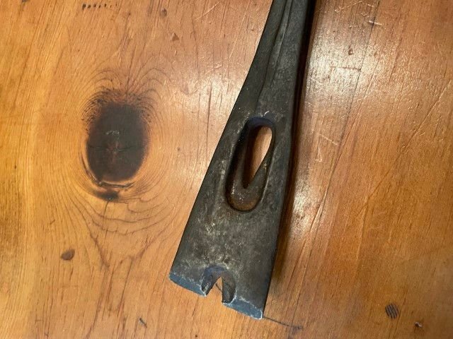

Last month I installed two new bump stops on the frame above each lower control arm . The old ones rotted out. So I lubed up the new ones and was well on my way to emptying out my tool box to get them pressed inside the receiving cup. Didn't take too long before realizing my best plan of attack was to stop and think...even if only for 30 seconds. This is what I came up with: A basic pry bar like in the first photo. Note in the second photo the indent for yanking nails (among 673 other uses). Place the bottom of the bump stop in the indent to sort of hold it in place. Line it up with the receiving cup and pry it into place. You should find something nearby the cup with which to pry from. It's a small sweet spot to balance but after 2 or 3 tries you find it. Beats the hell out of unloading your tool box.

That's a good hint I'd've never worked out (since my bump stops are different!)
