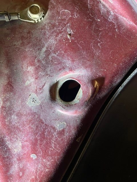

My hood bump stops. One is missing. Anyone know where I can get one? Truck specific or universal?
NEVERMIND. I found them at Amazon or RockAuto. OEM p/n 4103165
