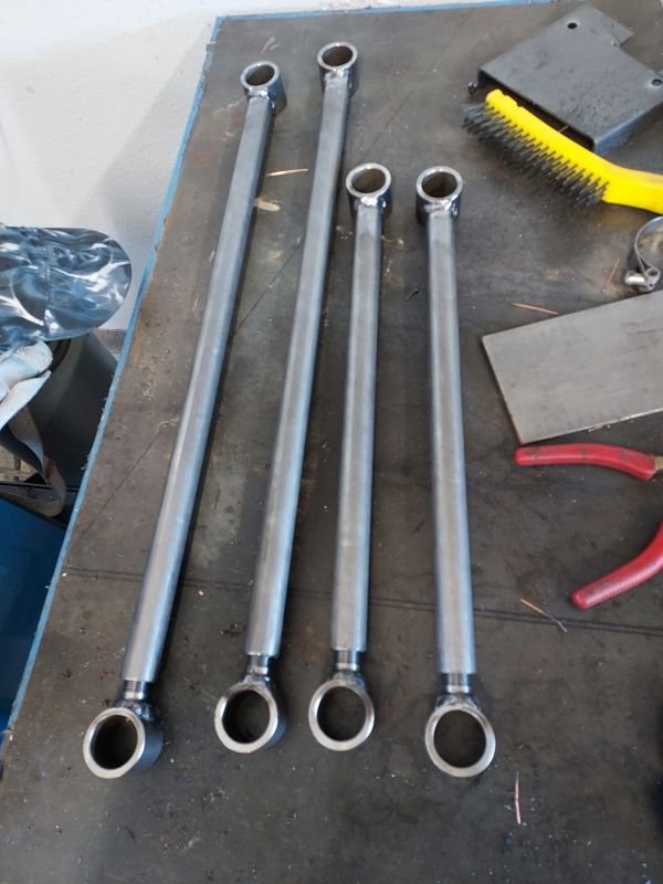

I got the four link bars all welded up. I am waiting for the 10 ga. (.135") steel sheet to arrive so I can box in the frame.
