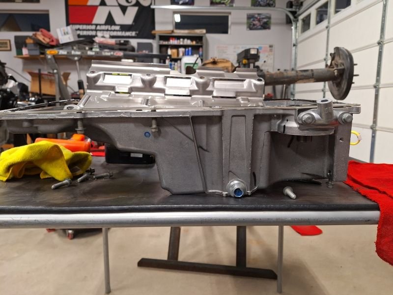

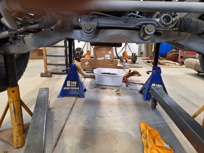

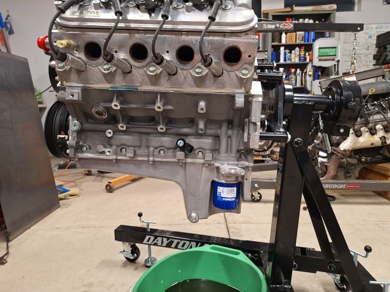

Boy, am I grinning!! That stand is sweet! I had to swap out the oil pan on the new engine. The LM7 pan clears the front cross member, the LS3 pan does not. I have to sacrifice some ground clearance to pull this off. I plan on welding a square steel tube under the cross member so it will hit and not the oil pan. The pan hangs down about an inch lower (last pic).

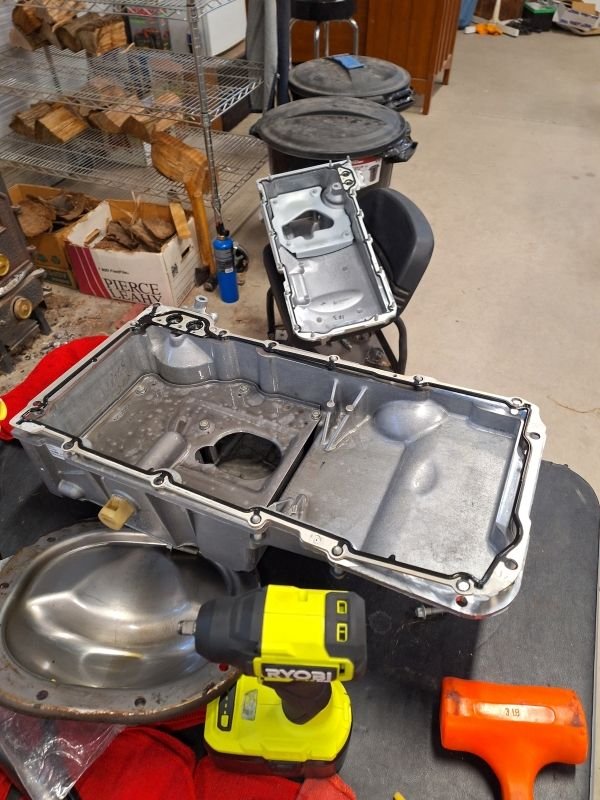

While changing out the windage tray and oil pump pick up, I got to take a gander of the innards on this engine.

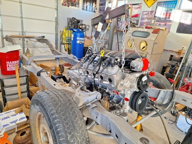

The first mating of the engine and trans, and the first test fit in the chassis.

Exhaust on that is gonna be TIGHT. I would try and avoid using stock manifolds......

I have headers that I already test fit using the LM7 engine, but with a 4L60E trans. I will put them one this set up tomorrow since the 6L80E trans is bigger.

Wow, those wrap rather nicely.
