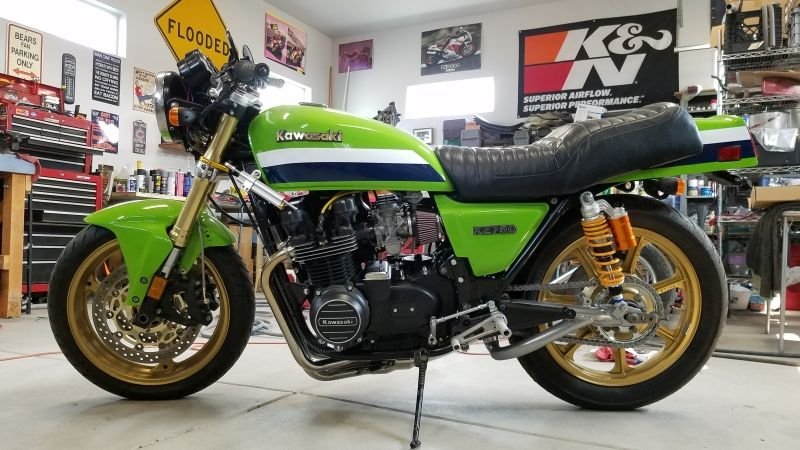

Since I am in northern Nevada, our average humidity is around 20%. I have seen it dip to single digits, but not too often. I do not have a rust problem up here! I bought some Chassis Saver paint, but until last week the temps have not been warm enough to use it. Also, I figured I would try to get some of the welding done to it before I paint it. If any rust starts to show up it will be real easy to wire wheel off before painting as well. You can see areas of rust where brackets or cross members have been removed. Those will get wire wheeled as well. I am itching to get my drivetrain components, but I have to sell a motorcycle project I am finishing up first. One project funds the next. I am currently 100 miles into a 500 mile break in period before I can list it up. This bike sat outside in So Cal for 28 years when I picked it up. Turned out pretty good!!
