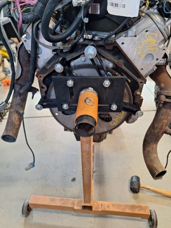

I finally got the LM7 up on the engine stand. Cheap stand = fitment issues. The four brackets and bolts were purchased from Jegs. The stand is from Harbor Freight. The original brackets were modified (permanently) for a Subaru engine. Thus the Jegs parts. The pivot tube was only welded to one side of the face plate, so I had to clean and weld the opposite side. Then the slots in the plate had to be widened, because the Jegs bolts were 1/32" bigger then the slot width. It should have been a bolt up operation, but sometimes I create my own problems. Now I can start the disassembly.

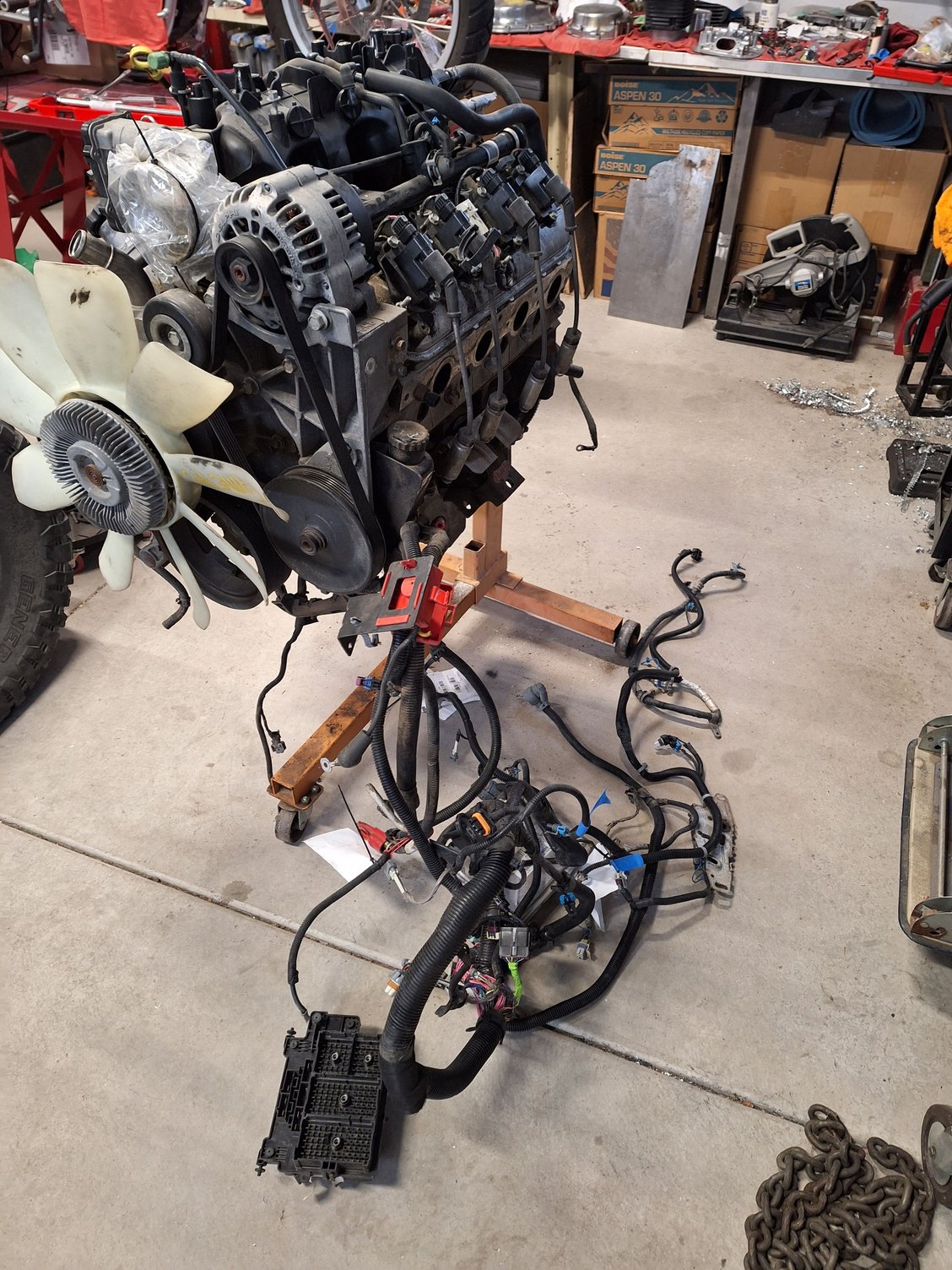

Posts: 668
Likes: 113
The engine harness is almost off. Taking it slow as I have an up coming CT scan on my back. Don't grow old, kids. It's a trap!
